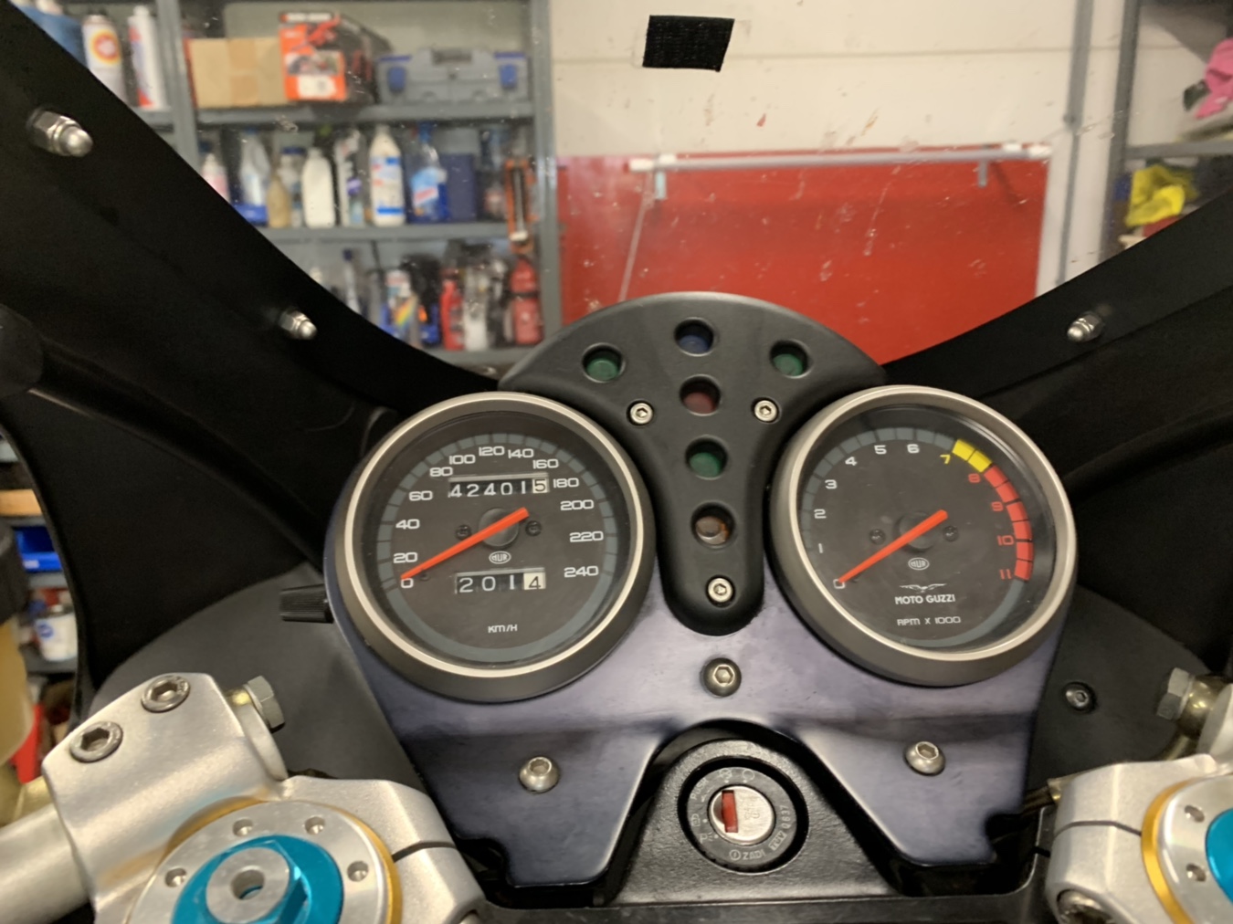

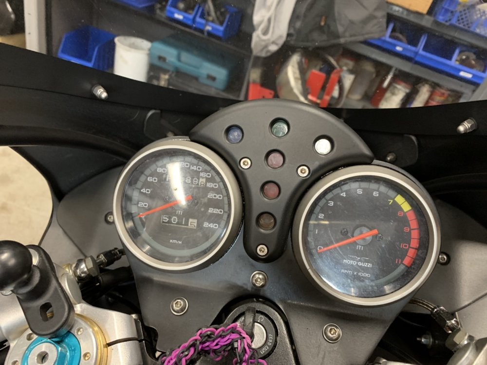

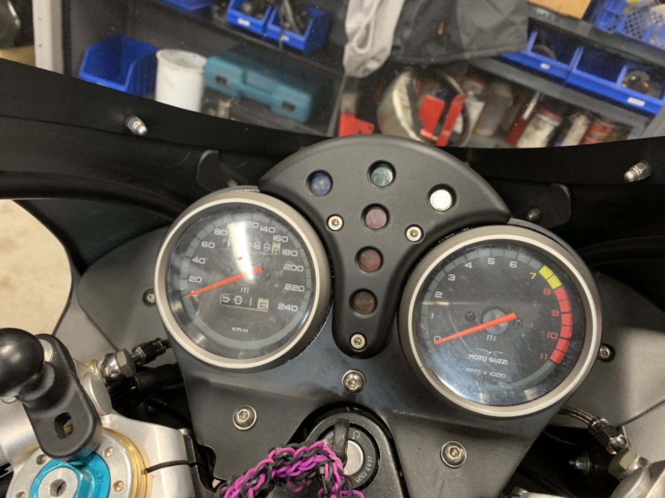

Dadparent Posted August 18, 2019 Author Posted August 18, 2019 Hè Docc Here are the pictures of both my dashes. No seperate warninglite in one case and the other has them. Was does it mean for you (and me ) ? Gr. DirkVerzonden vanaf mijn iPad met Tapatalk Pro
docc Posted August 18, 2019 Posted August 18, 2019 Which of your V11 are you installing the white face Veglia? And, will you keep your original warning light center console ? 1
Dadparent Posted August 19, 2019 Author Posted August 19, 2019 Its the one with pink key label And yes my original plan was simply changing the meters. Till you warned me for some difficulties. Verzonden vanaf mijn iPhone met Tapatalk Pro
docc Posted August 19, 2019 Posted August 19, 2019 I think you will be fine on the 2002 with no electrical changes at all. Keep your own center warning light console and speedometer drive cable. If the cable breaks, you can convert to the earlier angle drives, but they are also fragile and require some preparation and maintenance. Please post pictures of your LeMans with the Veglia!
