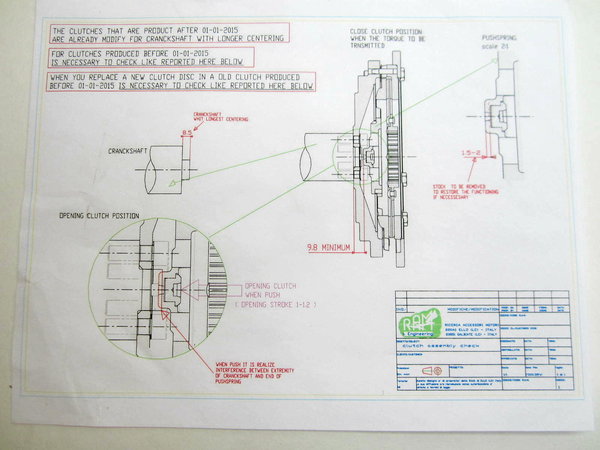

JKV11 Posted January 31, 2020 Author Posted January 31, 2020 I have found out that i probely have RAM 6 speed clutch. At Stein Dinse i orderd a RAM 6 speed clutchplate (https://www.stein-dinse.biz/product_info.php?products_id=461370), And it looks just like the one that came out of te Scura.But it is only 0.9 mm thicker then the old one New 6,1mm vs old 5,2mm). So i'm afraid that this one only wil last a few 1000km. I also took out the pushrod; I'm wondering or this is the wright one. And whether it was properly installed. The thin side was on the rear, in de slave clutch cilinder. Can anyone tell me or this is the wright pushrod is for the RAM 6 speed clutch? Kind regards, Jorrit
JKV11 Posted January 31, 2020 Author Posted January 31, 2020 Some extra info; If i look closely it seems like it was properly installed. but if i look a the clutch, it looks like it should be turned around I have another picture, where you can see the pushrod fits exactly in the spring, but i'm only aloud to upload 200mb
Lucky Phil Posted January 31, 2020 Posted January 31, 2020 12 hours ago, JKV11 said: Some extra info; If i look closely it seems like it was properly installed. but if i look a the clutch, it looks like it should be turned around I have another picture, where you can see the pushrod fits exactly in the spring, but i'm only aloud to upload 200mb Your rod has been installed the correct way around but at the clutch end the rod doesnt appear to have engaged the pressure plate button correctly which would mean the rod is in effect too long and possibly holding the pressure plate partially disengaged. This would cause slipping issues.This is one of the issues using a 5 speed RAM clutch with the six speed gearbox. You need to machine down the dia of the clutch end of the pushrod. To check the correct length of the pushrod once machined,install the gearbox and clutch with the pushrod and the pushrod bearing assembly and the piston and push it as far forward as possible then measure from the piston end to the gearbox face that the slave cylinder bolts to. With the single plate clutch with the original plate( same as I have fitted ) the measuremnt should be approx 18.5 mm. It about 19.5 with a partially worn twin plater. If you assemble yours as before and the measurement is say 14 or 15mm then thats almost certainly what been causing the slip due to the pushrod not seating in the pressure plate button and holding the pressure plate partially disengaged. Look for damage to the gearbox pushrod bearing and piston as well. If you use the later thicker friction plate you may need to modify the length of the pushrod and also the pressure plate button on pre 2015 RAM clutch assemblies. Ciao EDIT.....here's your answer.......3rd last post by footgoose
docc Posted January 31, 2020 Posted January 31, 2020 Here I thought the tapered, thin, machined end went into the clutch push button (forward)?
Lucky Phil Posted January 31, 2020 Posted January 31, 2020 20 minutes ago, docc said: Here I thought the tapered, thin, machined end went into the clutch push button (forward)? I had to think for a second as well docc but if you look at your images in the link when your input nut backed off you can see the non reduced end there. I also went and checked my old engine and the reduced end is definitely at the slave end. God I only assembled the Daytona engine a few months ago and I'd forgotten already. Ciao 1
