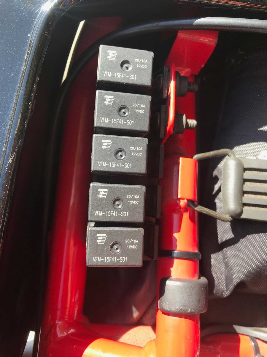

jetboy Posted August 16, 2019 Posted August 16, 2019 Hi: I posted over in Wildgoose Chase and they sent me here! I just got this 2000 v11 sport, it seems pretty much stock other than the added bikini faring. One thing they said over there is to upgrade the relays: but I was not sure how to tell if they were already upgraded, so here is a pic:

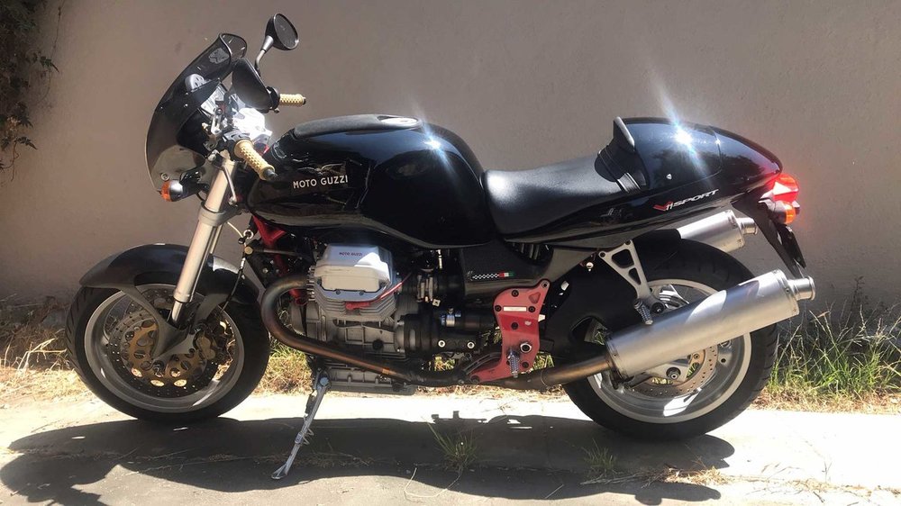

jetboy Posted August 16, 2019 Author Posted August 16, 2019 and a pic of the bike! a bit faded but not much changed off the floor. My friend commented: "Why don't you want to park your new guzzi on the street" when we were meeting up in west oakland (I'd parked on the dried up lawn in front of the house). I was like.. its nearly 20 years old! PO kept it pretty clean! 2

docc Posted August 16, 2019 Posted August 16, 2019 Those are not the original relays, but you can do better. Go to the “How to...” subforum and open the “Best Relay” thread. The last few posts link a source for Omron High Current relays. The reset knob screws on with a left hand thread. Maybe a little blue Loctite to keep it there. Best thing I’ve found for the vibration is a complete tune-up with meticulous throttle body balance. See “Decent Tune-up” in How To for a starting point. Enjoy your “new” Sport and welcome!

Lucky Phil Posted August 17, 2019 Posted August 17, 2019 On 8/17/2019 at 12:36 AM, jetboy said: yeah I saw your post and was trying to figure out where that bracket goes! I think i understand the issue- its only got the brackets on the rear of the transmission and the front is only held on by the bolts to the engine. Expand Looks clean, rare to see original relays and an unmolested relay base and wiring. How many miles? Ciao

footgoose Posted August 17, 2019 Posted August 17, 2019 Welcome Jetboy. Nice. Don't see many black ones. Those cans are aftermarket (this is good)
docc Posted August 17, 2019 Posted August 17, 2019 On 8/17/2019 at 3:47 AM, footgoose said: Welcome Jetboy. Nice. Don't see many black ones. Those cans are aftermarket (this is good) Expand My bad- I should have zoomed in on the cans to see they are not the original LaFranconi. Nice that it has been ridden and looked after. Seems the ones that have sat and sat and sat have a lot of needs.
