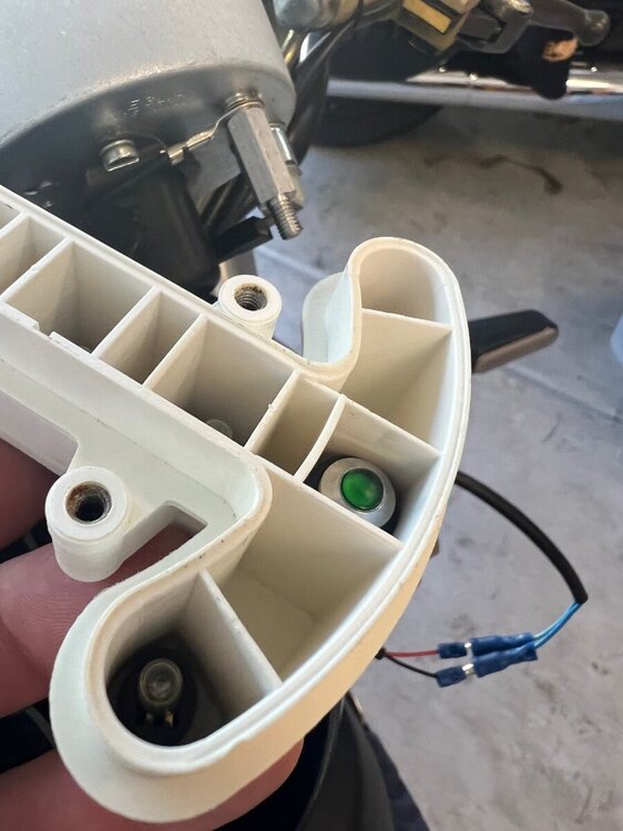

MartyNZ Posted July 28, 2024 Posted July 28, 2024 (edited) 12 hours ago, DucatiGuzziIndian said: Where does that nice white lamp holder come from? Mine has at least 2 previous epoxy repairs gobbed around the insert nuts.😄 Edited July 29, 2024 by MartyNZ

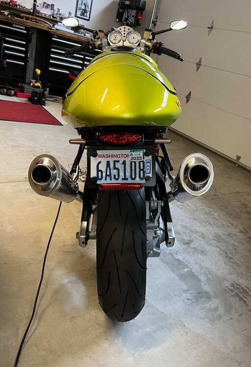

audiomick Posted July 28, 2024 Posted July 28, 2024 That looks like it has turned out nice. Well done.

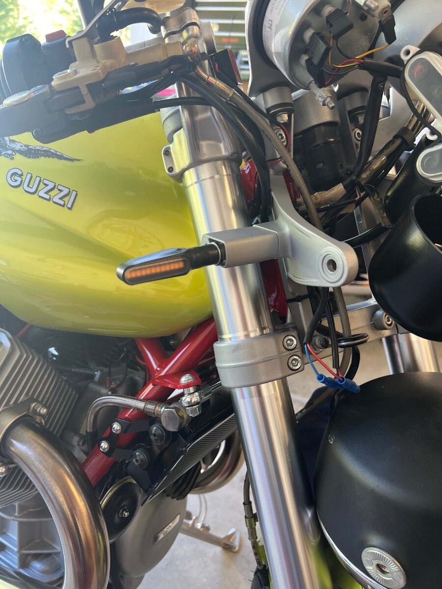

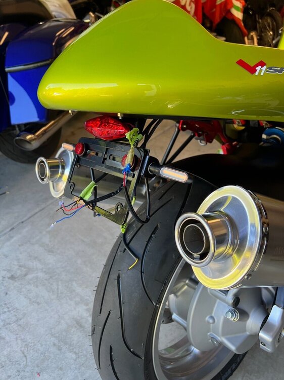

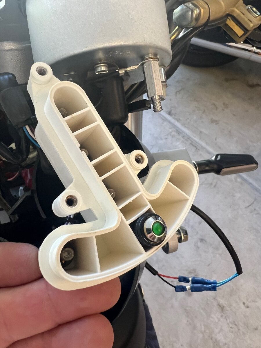

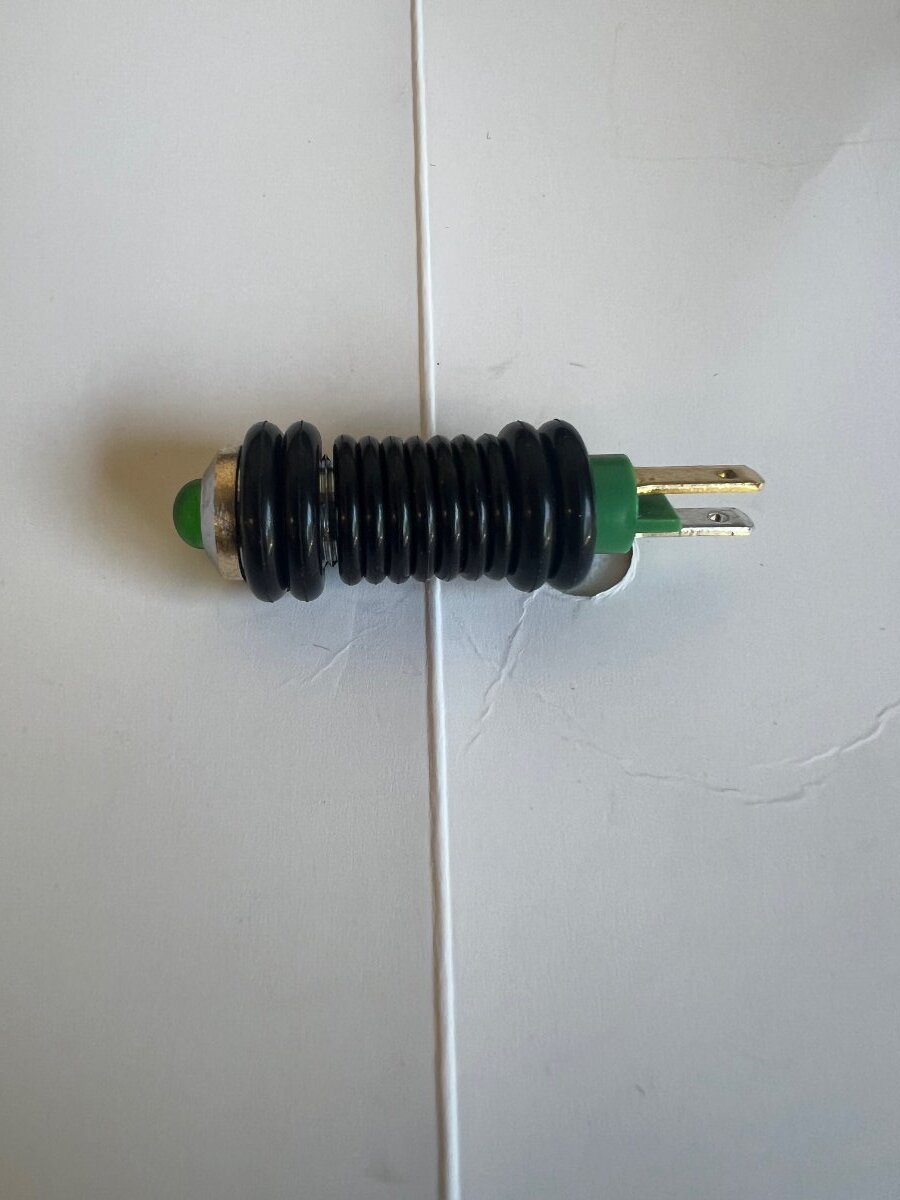

docc Posted July 28, 2024 Posted July 28, 2024 5 hours ago, DucatiGuzziIndian said: I managed to complete the LED turn signal conversion with the help of the great advice from you guys.... many thanks. I purchased LED turn signals and LED brake lights from Amazon and went to a local electronics supplier for the diodes and 12v LED dash indicator lamp. I had to file the new LED dash indicator lamp outer ring a little so that it fitted into the square hole in the instrument housing where the old lamp resided. I then added some small O-rings to the outer body of the lamp to take up the free play between the LED body and the hole it fitted into. These O-rings created just enough resistance to make sure it doesn't slide around in the hole so that was a stroke of luck. Proof positive that if you cannot fit a round peg into a square hole, Moto Guzzi may not be for you . . . Nicely done, @DucatiGuzziIndian! Thanks for sharing all the details! 2 3
DucatiGuzziIndian Posted July 29, 2024 Posted July 29, 2024 Marty Bike only has 3,000 miles on it (5,000k) And I'm a bit anal about keeping stuff in pristine condition.. I suffer from CDO (it's like OCD but all the letters are in alphabetical order as they should be!! ) Many thanks for your help mate! 1 4
