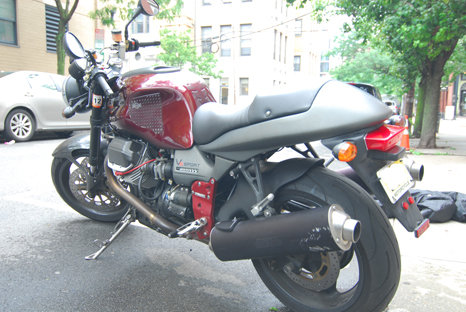

Bike is stuck in 2nd gear.  I've fixed it before but I'm done with this bike.  It has around 13,500 miles or so.  It actually runs very well.
Has fairly new tires, new oil cooler, new battery, new crank case breather hose.  Charging system works just fine, it always starts.
Local pick up only, I'm in Hoboken, NJ
Yes, replaced with upgraded one, it's probably the return spring that's stuck or something.  I've read a lot of the posts, repairs, mods.  I just don't feel like working on the bike.  I changed the spring probably 2-3 years ago, the company said the spring would not break.
