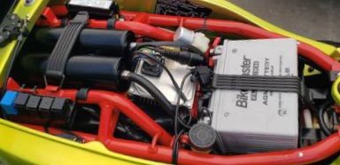

gstallons Posted October 2, 2019 Posted October 2, 2019 14 hours ago, Kane said: I checked out the ‘01 Green V11 that’s for sale in my area. It’s a title more expensive than the bike I was first looking at, but it is really clean and low miles. Sounds like thunder from heaven! I’m taking a second look at the first bike tomorrow, but this Greenie is pretty sweet. I do have a question: When the clutch lever is pulled while the bike is sitting at idle it makes a noisy rattle. He told me that it’s a dry clutch and that’s normal for these clutches. Is that correct? Also, there are two black cylinders under the seat just behind the battery. I’ve never seen these before, and they were not there on the first V11 I saw. What are these?: They are all part of the emission system . Leave them alone ( for now ) . I will figure them out and let you know how they work .
docc Posted October 2, 2019 Posted October 2, 2019 7 hours ago, Kane said: What looks off to you? 1) The "mix" of relays. It's not a bad thing that #5 looks larger, but I would replace them all with High Current OMRON (See "Best Relay" in How to . . .) 2) Not the OEM battery (Hawker Odyssey). Not sure what it is, but it should be given proper attention. The Odyssey PC545 have been known to give stellar performance.. 3) The "OBD" connector lying on top of the ECU should be tucked in back behind it so the seat does not make pressure down onto the ECU. no wiring should be against the ECU case except its main connector and its case ground. 4) The accessory wiring wrapped over the sub-frame tube should be groomed under it so that the seat will not crush it and possibly make a short. 1
Kane Posted October 2, 2019 Author Posted October 2, 2019 Wow. Good eye! Thanks for breaking it down into specifics. Much appreciated. Do you reckon this is how the bike came from the factory/dealership? The bike looks very mint, 10k miles, I am assuming unmodded or worked on beyond routine maintenance. But I really don’t know.
docc Posted October 2, 2019 Posted October 2, 2019 The blue relay has been added as well as the accessory wiring. The battery has been changed (you can check for a date code on that to see how fresh it is). The ECU ground to the corner of the case is typically on the left front (by the positive battery terminal!), so may have been moved. Worth checking all connections for tightness and treat with Craig DeOxit. Overall, no major changes or big concerns showing up!
docc Posted October 2, 2019 Posted October 2, 2019 It also looks like it has the original electric petcock. More indication the bike has not been messed with . But needs to be! 1
