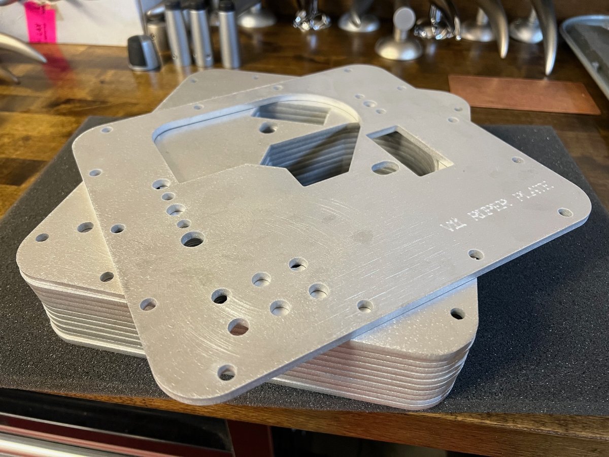

DucatiGuzziIndian Posted December 22, 2023 Posted December 22, 2023 Apologies for the delay but had work issues to deal with and the plates have been ready for a couple weeks.... Behold the beauty of the world famous Roper Plate. I'll be getting some packaging material sorted out for these next week so I can start shipping out shortly thereafter. Thanks for the patience everyone. Cheers 2
footgoose Posted December 22, 2023 Posted December 22, 2023 are they thicker? Thinking about the kickstand mount issue/non-issue already present with the earlier plates 1 1
DucatiGuzziIndian Posted December 22, 2023 Posted December 22, 2023 I just came back to the screen here after unpacking them and checking the dimensions and the idiots at the waterjet facility cut them from the same 3/16" thick material as my other parts, not the 3mm material (aluminum) I requested. I'll be calling them as soon as they reopen to get it fixed. I should have opened them and inspected them when I picked them up but you expect these people to get things right. But footgoose... you make me ask if there was a prior issue with thickness?? surely a mm or so here or there isn't a deal breaker ... but if there is past experience i am unaware of please tell me asap... Thnaks 1
docc Posted December 22, 2023 Posted December 22, 2023 54 minutes ago, DucatiGuzziIndian said: I just came back to the screen here after unpacking them and checking the dimensions and the idiots at the waterjet facility cut them from the same 3/16" thick material as my other parts, not the 3mm material (aluminum) I requested. I'll be calling them as soon as they reopen to get it fixed. I should have opened them and inspected them when I picked them up but you expect these people to get things right. But footgoose... you make me ask if there was a prior issue with thickness?? surely a mm or so here or there isn't a deal breaker ... but if there is past experience i am unaware of please tell me asap... Thnaks Here is a reference image indicating the fastener that would struggle to align when the sump spacer is set off further from the engine case. Some installers reported being able to get the fastener to thread in. Others have reported relieving (filing oval) the hole in the sidestand mounting plate. I would be concerned about creating excessive lateral stress on the sump spacer forcing the fastener in without creating some relief. 3/16" is almost double the thickness of the original P.Roper motomoda plates, if my measurements are close ( 0.1875"/~4.75mm vs ~0.098"/2.5mm). 1
DucatiGuzziIndian Posted December 22, 2023 Posted December 22, 2023 OK Wish I had understood this earlier. Plates need to be as thin as possible then. Let me think about this. 3
pete roper Posted December 23, 2023 Posted December 23, 2023 The reason I went to stainless in 2mm is because thinner alloy would fatigue and crack. You could find chunks in the sump! Not good. The 2mm option worked withou issue in most cases but 1.5 might be better and I reckon it should be strong enough. It is a good idea to make the bolt holes slightly larger than 6mm simply to allow for inaccuracy in the cutting. 1 1
DucatiGuzziIndian Posted December 23, 2023 Posted December 23, 2023 All good info to have,... now,.... thanks! Seems as though the material MUST be 2 mm stainless then..... oh boy.. Back to everyone in a few days after I talk to the waterjet guys. 2

footgoose Posted December 23, 2023 Posted December 23, 2023 5 hours ago, DucatiGuzziIndian said: But footgoose... you make me ask if there was a prior issue with thickness?? surely a mm or so here or there isn't a deal breaker ... but if there is past experience i am unaware of please tell me asap... Thanks I'm running an original Roper plate. It was 'almost' a non issue for me. I used a rat tail file in the hole on the top side ever so slightly and it cleared nicely. Others have had different experiences. Gasket material obviously plays a role. For myself, it could have been slightly thicker and still worked. 2
