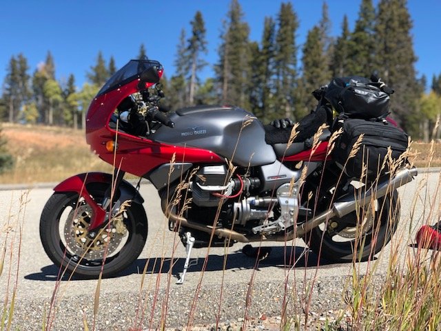

Gmc28 Posted September 30, 2019 Author Share Posted September 30, 2019 In Durango, bike running sweet, and many happy smiles/curves behind me. Route 64 between Taos and Chama is not to be missed if in the area, myself only getting to it by accident after missing a turn and not noticing for too long, causing that excellent re-route. still not good idling, and that 3000-ish rpm stumble, and worse than it was a week ago, but as of a week ago she had been mostly sitting for a long time, so thinking the use/miles are getting things stretched and worked, which is good, but likely means a handful of adjustments later. 4 Link to comment Share on other sites More sharing options...

Gmc28 Posted October 2, 2019 Author Share Posted October 2, 2019 Thx all- did a half assed job of capping/unplugging the lines. Will need to get her home to dig in and do it right, to assure I have properly cleared or capped lines, but think we’re good for now. But no issues running today, other than crappy idling, after 8.5 hrs in the saddle, including some very spirited riding, several hours of freeway droning, and then capped with some lovely stop and go traffic in Salt Lake City when my ass had already had about all it could take. She purrs like a proper italian now at mid range rpm, where she’s living most of the time on this ride. man, the million dollar highway (hwy 550) with only a handful of midweek, off season cars was moto-heaven. When I die, bury me right there. And the run from Ouray over to Moab.... almost as good, and basically no cars for 2 hrs, so that’s pretty much a full house right there. Thank u motorcycle gods for your plentiful bounty... 5 Link to comment Share on other sites More sharing options...
