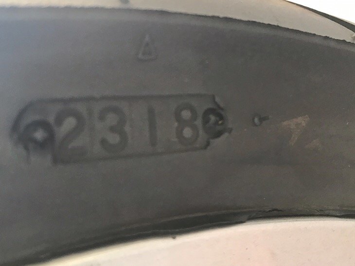

LowRyter Posted October 7, 2019 Posted October 7, 2019 1 hour ago, Kane said: Rear tire: Just ride it. 2
