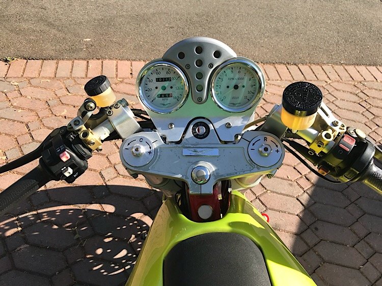

Kane Posted October 5, 2019 Author Posted October 5, 2019 The toggle switch on headlight bracket that I mentioned:
Kane Posted October 5, 2019 Author Posted October 5, 2019 14 minutes ago, footgoose said: ha ha.... nice Thank you! What do you guys think of Shinko tires?
po18guy Posted October 5, 2019 Posted October 5, 2019 I think that Guzzis are somewhat like Colt pistols and revolvers: more the exception than the rule, with each being one-of-a-kind. It seems as though the assembly workers simply grabbed whatever was nearest and bolted it on. Mine has a different ign switch, but it's still somewhat puzzling how to get to lack/park positions without some monkey motion. The toggle? Flip it and see if the charge light remains on as long. Someone with greenie experience will chime in. Back in the 1960s, Ducati singles had a mystery toggle switch on the tailight mount. No one could ever determine what on earth it did, so we assumed that it was Italian law that each motorcycle had to have a toggle switch somewhere. ShinKo tires are probably very good for a "sports-touring" app. I think they would go away on a track day - but that is not their purpose. The universal joint? Virtually every American and most European cars with U-joints left them open. Better to shed any heat buildup, easier to clean and to maintain. A leather cover would be really cool - covering only the fixed (silver) part. Underseat looks very good - not messed with. Funny that my '04 Ballabio has no chin pad on the tank, so they painted a faux chin pad on. Now that's Italian!
Lucky Phil Posted October 5, 2019 Posted October 5, 2019 Yes the exposed shaft is standard, the alternator light should go out as soon as the engine starts, no idea what the three way toggle is as its not standard, the left front indicator mount looks damaged, the seat cowling needs some large headed chrome attachment screws and the canisters under the seat need to go. A few little items to keep you amused. I'd look into the alternator light and the three way switch first. Check the battery and alternator connections as a start to basic troubleshooting. To lock the steering on my bike you need to push on the key, release and then it will turn to the locked position while you hold the steering a little off the steering stop. If you push and hold the key down it wont turn to the lock position or if the steering is all the way on the stop it wont lock either. all my other bikes you pushed the key down and held it down to go to the locked position but not the Guzzi it appears. Also check the toggle switch isnt wired into the regulator sensing system Some people replace the std reg with a unit that bypasses the ignition switch which works fine except it drains the battery after sitting for long periods. Maybe they wired a switch in the system or an anti theft device? There's plenty of help here if you need it. Ciao
po18guy Posted October 5, 2019 Posted October 5, 2019 All great ideas. Perhaps attach a voltmeter/multimeter to the battery and note the voltage when the light is on and see if it changes when the light goes off. It "may" point to a rectifier problem. The toggle? The bike may have had aux fog lights or??? added and the toggle would control them. Oh, and the rattle with clutch in? That helped me figure out why I like Ducatis: with their 90º exhaust cadence and rattly dry clutch, they remind me of a Guzzi! 1
