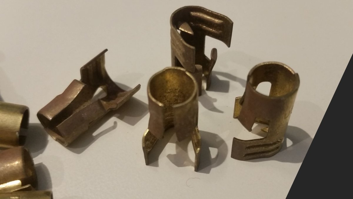

PJPR01 Posted December 23, 2019 Author Posted December 23, 2019 Well...I got both sets of wires as suggested above and the Harper's set, but the plug ends I tried to use for the red NGK's were the wrong ones, so I decided to use the set I received from Harpers. Basically you cut the wire in half, thread on the end caps and voila, you have a pair of plug wires in 2 minutes flat. They made an amazing difference, bike runs noticeably smoother...I'm guessing that my old plug wires may have been either originals or quite old, but happy to have a new set on...black, rather than red, but functioning perfectly! Still hunting for where I can find the right size metal end caps (the part that fits into the distributor end) for the NGK's so I can keep those as a backup...
footgoose Posted December 23, 2019 Posted December 23, 2019 I'm not sure I understand why they won't work. They won't attach to the spark plug? or the other end at the coil
PJPR01 Posted December 23, 2019 Author Posted December 23, 2019 Well...the red NGK's didn't come with the metal end that gets inserted into the coil, so I had to buy some after market ones by guessing looking at my originals. Unfortunately the ones I bought were the wrong size and I could not get them to insert...in the meantime, the set from Harpers had arrived and they came already prepped with the coil end on the wires, and all I had to do was attach the plug end.
MartyNZ Posted December 23, 2019 Posted December 23, 2019 1 hour ago, PJPR01 said: Still hunting for where I can find the right size metal end caps (the part that fits into the distributor end) for the NGK's so I can keep those as a backup... I have some end caps you can have for nix. They are made for 6mm cable, so you would need to trim 8mm cable a little. PM me your address. 1
