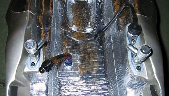

al_roethlisberger Posted March 5, 2004 Author Posted March 5, 2004 ....washing machine sprung a leak, so my progress has slowed a bit on this project, but all-in-all it may be a good thing For example, because of delays, I was able to leave the tank full of gas on a rack, sitting in the Sun, for two days.... to see if it would leak. "Knock on wood" but so far... not a drop But I was able to get a few things done: - Got the new tap installed under the tank(only possible if one has removed the airbox) including self-sealing quick-release - cleaned the tank - reinstalled manual petcocks, fuel level sensor - installed new heat-reflective barriers on tank(including above cylinders) - mocked-up fuel-line routing Some photos:
al_roethlisberger Posted March 5, 2004 Author Posted March 5, 2004 A little closer, taking in both petcocks, and the fuel-return. The gold/black fitting is a self-sealing quick-connect Nothing like disconnecting a fitting and having all the fuel dump out!
al_roethlisberger Posted March 5, 2004 Author Posted March 5, 2004 And closer yet ....just in case you missed it in the last two posts
al_roethlisberger Posted March 5, 2004 Author Posted March 5, 2004 Here is a shot of the inlet inside the tank, taken through the neck. All that goop around it is some stuff from Peratex that is supposed to be used to seal stuff like this, and is "resistant to fuel" ...hence my testing for the last few days The place I pierced the tank was the most accessible, and relatively flat enough to get a good seal. In actuality, I don't even think I needed the "goop" so much, because if you ever remove the stock petcock/sensor base, you'll find that they're only sealed via a single o-ring, two bolts, and some similar non-curing "goop"... and my inlet is on much tighter ... again "knocking on wood" Also, the inlet is a very tight fit in the hole I drilled, and actually is threaded into it. So that should help sealing a little bit as well. What you also can't really see is that the inlet is reinforced by some extra wide stainless steel washers to reinforce against and distribute any undue force on the tank material. Hopefully this will prove sufficient over time. I have to say I was pleasantly surprised by the durability/toughness of the tank plastic when I was drilling and wrenching on it. So time will tell I guess... here's hoping And if I can manage to get a wrench in there(wow it's hard, the neck is so narrow), I also plan to put a 90-degree fitting on the inlet inside the tank so that the fuel doesn't shoot up, and run right down the fitting. I don't think it will make a huge difference in durability, but I'd rather not have fuel splashing right down on the location where the fitting is sealed piercing the tank. ...don't want to push my luck, and everything helps P.S. You can see on of the white vent/drain tubes inside the tank in the photo.

Guest IanJ Posted March 29, 2004 Posted March 29, 2004 So, Al, can you describe your new system in an "overall" way? I'm unclear on what all you've changed and what problems you've worked to solve. Ideal would be a diagram, but I'm interested in whatever you can elaborate upon.
