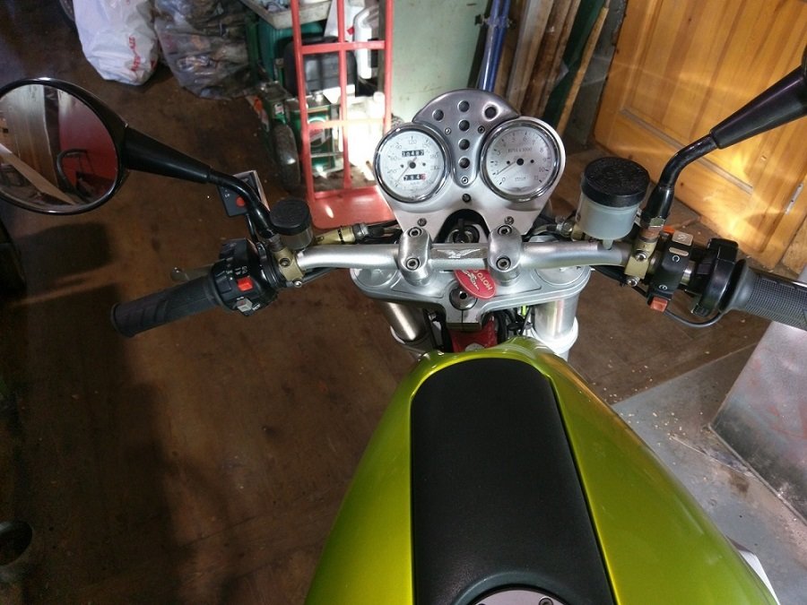

Emeraldv11 Posted January 14, 2020 Posted January 14, 2020 16 hours ago, marktheaxeman said: Hi Luc, I like what you've done there - but I dont think that will work with my brake pedal as its not the standard one and doesnt have a flat edge to it. I think my foot rests will be in roughly the same position as yours though once i spin my rearsets around by 180 deg. Do you have any trouble with them grounding out at all? Are they much more comfortable? Cheers, Mark. Hi Mark, yes , they are more comfortable as for grounding its not with the wet and greasy roads we have at present in the Cork-Kerry mountains that i will be trying to lean too far ... I changed the bars as well for a second hand triumph set and between bars and foot pegs it makes for a much easier ride with less weight on the front wheel. AND : heated grips...(used to be for Sissies but perceptions changes) 1
marktheaxeman Posted January 16, 2020 Author Posted January 16, 2020 Hi Luc, That looks just the kind of set up I'm after. Did you drill the top yoke yourself and what bar clamps did you use? I like the ideal of being a little more upright. I guess you have to replace the throttle cable and clutch line? Thanks for your help, Mark.
GuzziMoto Posted January 17, 2020 Posted January 17, 2020 Some V11's came with handle bars like that. But not the red frame greenies (which are the best V11's). However, you can either swap the top triple clamp for one from a V11 that did have the handle bars, or you can simply drill the holes in the top triple clamp and mount the handle bars using either stock bar risers or aftermarket bar risers. The bosses to drill for handle bars are typically there, just not drilled. I drilled the top triple clamp on the wife's red framed silver V11, and mounted the stock risers from a V11 Ballabio. I believe I even used the Billabio bars.
