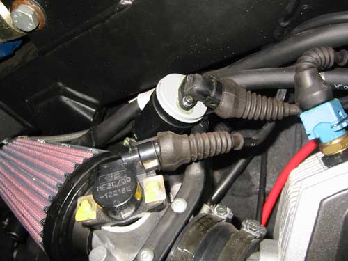

Admin Jaap Posted March 3, 2004 Author Posted March 3, 2004 Here's a pic how I did it (Thanks to John O'Sullivan for the film box idea) I made an opening in the bottom of the box. (I had to use zip-ties... )
Paul Minnaert Posted March 3, 2004 Posted March 3, 2004 You did open up the box ? It needs the real intake air temperature.
Admin Jaap Posted March 3, 2004 Author Posted March 3, 2004 I made an opening in the bottom of the box.
