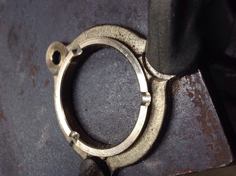

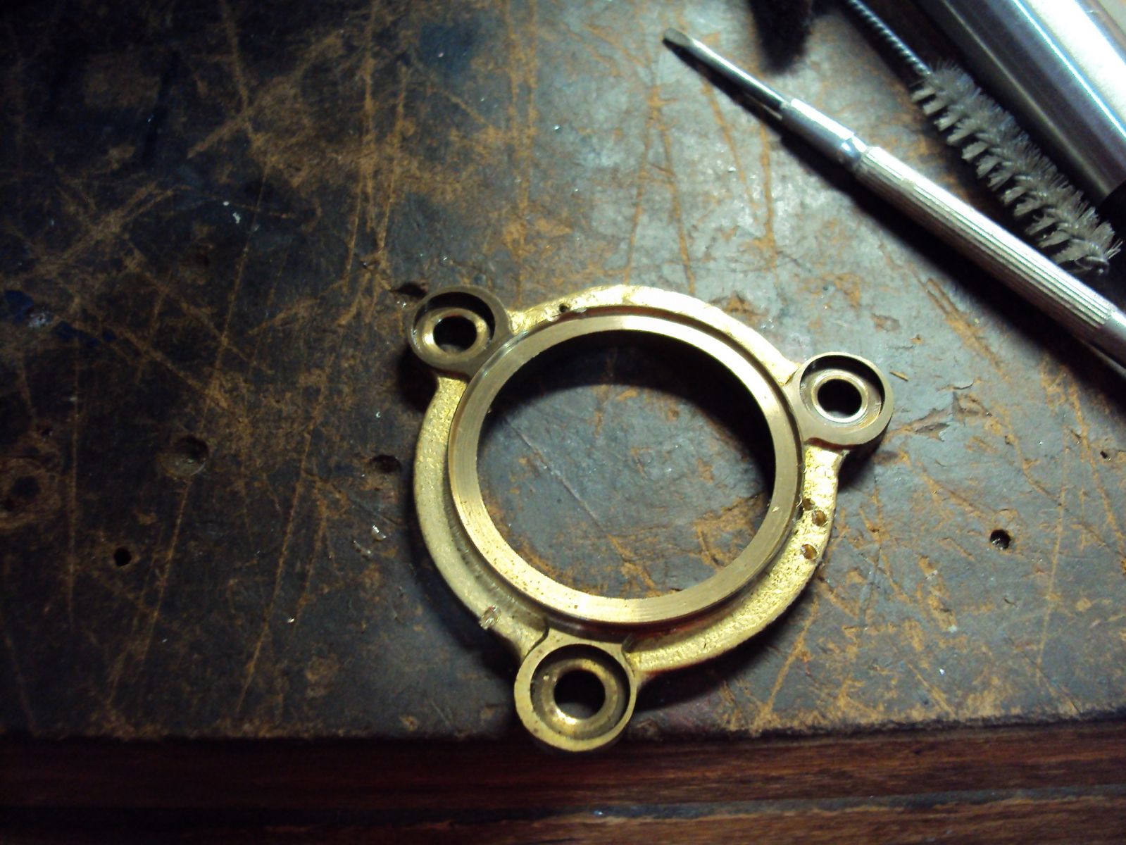

Pull back and forth on the cam sprocket and feel for end float. The earlier retainers didnt have any oil relief grooves cut into the face and tended to wear while the later ones had 3 oil relief grooves. If you have the older type and its new or not heavily worn you can file the grooves in yourself with a round file or use a 6mm parallel rotary cutter in a hand drill and do it.
Here's a brand new latest type with the oil reliefs in the thrust face.

Hears the old type with no oil relief and heavy wear on the thrust face. Notice how the cam sprocket flange has worn down into the retainer thrust face in this case probably close to 1 mm. It"s so perfect looking people think recess into the thrust face is normal and they reinstall it during rebuilds. Its not it's actually heavy wear as you can see by the comparison with the new one. Without the oil reliefs as the sprocket flange wears into the retainer thrust face it exacerbates the lack of oil issue as it creates the small ring which inhibits oil supply even more and it gets worse as it wears. The more wear the more shielding and less oil. A spiralling situation

You dont need to pull it to see the wear. Its on the font thrust face. I can see it has wear just not to what extent.It doesnt look really bad as there's no marking on the front main bearing flange at 12 oclock from the phonic wheel which happens with a really worn bush as the cam floats for and aft.
Here's a new one with the oil relief cutouts
DSC00719
Heres a worn one without the oil reliefs.Note the sharp lip on the edge of the thrust face.
DSC00732
