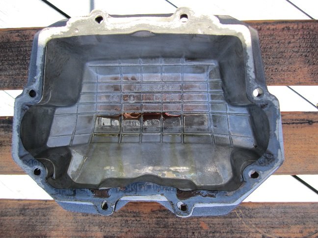

Nihontochicken Posted January 23, 2020 Posted January 23, 2020 My first oil leak (I think, I hope!) just started recently, originating from the lower edge of the left cylinder valve cover. I checked the bolts, which were not loose, but not tightened very well at the bottom. I torqued them down, but no cigar, the leak continued. Removal of the cover revealed the problem: Close up of the culprit: It appears that with the lower bolts not properly tightened, the gasket edge migrated away from the mating surfaces to the inside until a flow path was opened. So this leads to a few questions. If repositioning the gasket fails (which I anticipate), where is the quickest and/or cheapest place to get a replacement gasket, or would I be as well off to cut my own from stock gasket material? Also, I noticed all the hold down bolts were the same size except the top rear bolt, which is markedly shorter. Is this correct, or a Bubba mistake? Also one and only one steel washer dropped free from one of the bolt seats. Should all, some or none of these Allen head hold down bolts use washers? TIA for any and all enlightenment! 1

80CX100 Posted January 23, 2020 Posted January 23, 2020 Do yourself a favor and pick up a couple of pair of Valopini valve cover gaskets & you should be good for life. Pete and other guzzi gurus have been singing their praises forever; it took me a while to line up a supply of them, but I like them so far. They are the heavier material black ones, that I think are reinforced with wire or metal in the core. They should be available from MGCycle or AF1 possibly other suppliers or shops near you. I've used factory MG green ones,beige ones black ones, I even had a Griso that came with a set of Real Gasket ? silicon (PO had over tightened); they all leaked at some point of time. If you're handy and have the material, you could certainly make up a set to keep you mobile. I've had trouble before with the gaskets moving around on installation, a few dabs of grease helps hold them in place for me, I've also found tightening them too much and crushing the gasket can cause leaks. Good luck Kelly

docc Posted January 24, 2020 Posted January 24, 2020 11 hours ago, Nihontochicken said: Thanks for the responses so far. Again, are all the cover bolts supposed to be the same size, and do any/all utilize washers? Inquiring minds want to know! Affirmative: all same length. And overtightening is likely to "squoze" the gasket out of the contact surfaces. Someday (I'm pretty sure) I'll need to replace my originals . . .
Scud Posted January 24, 2020 Posted January 24, 2020 If I recall correctly, the top bolts have washers, but the lower bolts, which go through the head guards, do not have washers. 2
Chuck Posted January 24, 2020 Posted January 24, 2020 The Kid saved an early 1100 Spot a few years ago. For it's "shake down" run we rode to the Carolinas and camped/moteled for a week. It was the first time he really rode it in anger and it sucked the valve cover gasket inward. Cost him a t shirt to do a field repair at camp. When I asked Pete about it, he said that was common with the "factory" gaskets. You can see where it is sucked in between the bottom two screws. 2017-06-04_01-30-18 by Charles Stottlemyer, on Flickr
