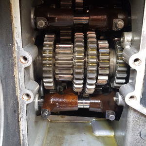

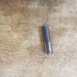

cash1000 Posted February 11, 2020 Author Posted February 11, 2020 With a little help from MartyNZ I have solved my gear box problem. The cause was a peg that had fallen out of the gearbox selection panel. When I took the panel off I found the peg in the bottom of the gearbox. It had fallen out of the hole that's indented it the middle the panel. Thankfully it had not caused any damage to the gears. After we had checked there was nothing else wrong with the panel we hammered the peg back into the panel after coating it with medium Loctite. I see later model V11’s have a nut & bolt to replace the peg. I presume that someone else had this problem. Anyway bike changes gear fine now. I checked the frame number and its within the range that its it eligible for the transmission upgrade. I need to follow up on this. 3 1
Lucky Phil Posted February 11, 2020 Posted February 11, 2020 51 minutes ago, cash1000 said: With a little help from MartyNZ I have solved my gear box problem. The cause was a peg that had fallen out of the gearbox selection panel. When I took the panel off I found the peg in the bottom of the gearbox. It had fallen out of the hole that's indented it the middle the panel. Thankfully it had not caused any damage to the gears. After we had checked there was nothing else wrong with the panel we hammered the peg back into the panel after coating it with medium Loctite. I see later model V11’s have a nut & bolt to replace the peg. I presume that someone else had this problem. Anyway bike changes gear fine now. I checked the frame number and its within the range that its it eligible for the transmission upgrade. I need to follow up on this. Later bikes have an eccentric adjuster instead of the roll pin. Cant really see it makes any difference to shift action unless you have the adjustment wrong. Early recall transmissions needed upgraded selector sleeves and belville washers on the output shaft damper. Acquiring the parts may be an issue these days if it hasn't been done and the entire trans need to be disassembled. Ciao 2 1
Bastiaan Sponton Posted February 13, 2020 Posted February 13, 2020 A view months ago I had the same thing. Did some research here but found nothing on this subject about how and why. Just hamert it back and everything is fine. Verzonden vanaf mijn iPhone met Tapatalk 2
cash1000 Posted February 17, 2020 Author Posted February 17, 2020 Good to know I'm not only one who has had this problem
Bastiaan Sponton Posted February 17, 2020 Posted February 17, 2020 2 hours ago, cash1000 said: Good to know I'm not only one who has had this problem The next service interval i will check the pin, if its moved I will order a new pin or do a modification. 1
Lucky Phil Posted February 17, 2020 Posted February 17, 2020 35 minutes ago, Bastiaan Sponton said: The next service interval i will check the pin, if its moved I will order a new pin or do a modification. Green or red loctite is your friend in this matter. Ciao 2
