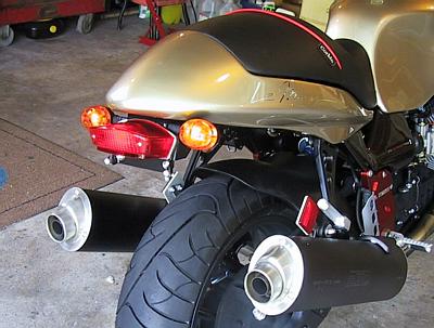

al_roethlisberger Posted March 2, 2004 Posted March 2, 2004 Check out our forum Tail-light/Fender Eliminator FAQ There are several options, including the aluminum job I got from Kelly Baker Performance. I don't know if he is still making them, but he was 18 months ago, and was converting future models to carbon fiber. If you are interested, give him a call. He's a great fella, and offers fantastic customer service

al_roethlisberger Posted March 2, 2004 Posted March 2, 2004 Fits much better than the hideous OEM. ....aww now, be nice........ I actually like the OEM tail-light Honestly, I do al
