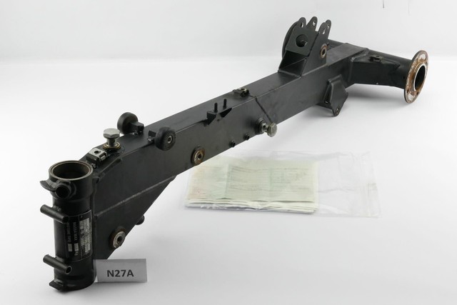

footgoose Posted March 19, 2020 Posted March 19, 2020 Good luck with all that Zooter, wish you the best. I bought a bike that was crashed. A member here bought it from the ins co and rebuilt it. Wasn't too bad he said. I bought it for parts and it rode very nicely. I stripped it completely. With everything off, the main frame is basically a 2X4 with a cylinder attached at each end. Vertical one at the front for the forks and a horizontal at the rear that the chops attach to. It's obvious to me it would twist easily with enough force. I casually put a couple of 6' pipes through the frame cylinders to form a cross and they didn't look right. I think it's a little twisted. If I have a go at it again and do it right, with help, I think it could be straightened. If yours flipped it's most likely tweaked. If you did rebuild it, what would the title show? In US we get a 'rebuilt' or 'salvage' title, which lowers resale value considerably.

80CX100 Posted March 19, 2020 Posted March 19, 2020 6 minutes ago, Zooter said: Taking best of care but not getting far trying to get tested at the moment. Plenty of food in the house. Any measures I take have to be as it sits at the wrecker's. Hard to visualize anything straight line, too much exhaust and tank in the way. Any cunning ideas? I could measure pork chops to steering centre point somewhere with string but no guarantee bike is actually fully symmetrical there by design. Dammit I like Foot's photo of the frame with the 2 cylinders at either end and his idea of throwing a 6' sraight bar through the back holes in the pork chop area. The pipe/bar may give you a visual idea if something is wonky, but if you measured it carefully and secured it centered in the frame, the ends of it could give you a point of reference to verify measurements to vital parts of the frame, fwiw.
