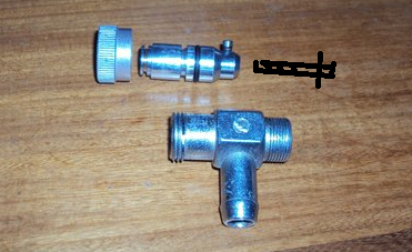

Lucky Phil Posted April 5, 2020 Posted April 5, 2020 Some of you may be aware of my ongoing frustration with these things. Briefly I've had one that refused to close off and another that has leaked when in the open position. Time to investigate. I suspected that the issue was junk seals and it turned out I was correct. I carefully removed the crimped section of the aluminium operating knob so I could screw it off the body and remove the internal plunger. The seals were toast which was causing the leaking in the open position. Bearing in mind that this thing gets used once in a blue moon the seals shouldn't have an issue really. So seals removed measured up and left in fuel overnight. I also tested a seal from an elcheapo kit I bought at the local Aldi store for comparison. No idea what the Aldi seal is made of but it was almost an identical size to the original. The first image shows the two seals after 24 hours in fuel ( the originals hadn't seen fuel for a week or so) As you can see the original has swelled a lot, around 1 mm in dia. So if your manual tap is difficult to open and shut and needs pliers to do so here's your reason. Garbage non fuel compatible seals. My cheap control seal is fine and hasn't swelled at all. This sort of thing drives me nuts, to save pennies they use rubbish seals and to compound the issue they aren't replaceable.......until now,hopefully. The difference in the seal sizes is quite obvious after 24 hrs in fuel. So what we need is Viton or FKM seals which I suspect will need to be 10 mm ID X 2.4 mm CS. I'll confirm this soon. The problem is what to do now with the the tap and its lack of open stop since we have removed the crimped section from the knurled nut. The issue for me is the lack of equipment. I've got plenty of nice ideas but dont have a mill which would allow me to do it properly. What I came up with is in the following image. I drilled and tapped the plunger for a 4 mm grub screw that can be inserted into its hole through the tap outlet. This grub screw when installed now forms the down stop for the plunger internally by it striking the inner bottom edge of the outlet hole replacing the crimped section of the aluminium knurled nut. The only issue I had was that I drilled and tapped the plunger hole about 1 mm too high which caused issues when the tap was closed. I resolved this by opening up the throat of the outlet port up near the closed seal face. Downside? a reduction in outlet area but i doubt it would be an issue as the inlet and filter screen are smaller than the tap outlet spigot ID.Next time I'd drill and tap a 6mm access hole on the tap body opposite the outlet port and make the 4mm hole in the plunger all the way through. I'd then have a 4mm stainless grub screw with the stop end turned down to 2 mm and it would be accessed through the 6 mm body screw from the opposite side. This would be much neater and minimise the loss of outlet area. The 6 mm access screw hole would need to be sealed with some thread sealer but the tap could be easily pulled apart for seal replacement and servicing.Note here only 1 seal is fitted to the plunger. I give this idea to the greater Guzzi community and forego retiring in luxury on the Caribbean on the obvious fiscal benefits I could derive from patenting etc. Ciao 5 2

Lucky Phil Posted April 5, 2020 Author Posted April 5, 2020 On 4/5/2020 at 11:09 PM, knumbnutz said: Hey Phil, Just a question since you have it apart, would drilling and threading at the small end in a lathe and putting a stop in along the axis work? Could be adjusted for height this way. Expand The issue there is that the plastic strainer threads into the body ID. Do you mean a stop that somehow uses the top surface of the body on the tank side? If so you would need to leave the strainer off and you would also lose inlet flow. I thought of a better solution initially but you need a Mill. Drill a 6 mm hole in the body opposite the outlet and use a screw with a 3mm spigot/projection machined at the end maybe 4 or 5 mm long that engages a 3 mm wide x 2 mm deep x 6 mm long slot machined into the plunger minor diameter. Insert the screw with the spigoted end which engages the slot in the plunger and you have your down stop and a guide to prevent the plunger rotating and you lose no flow at all. Its then dismantleable and all thats needed is a drop of sealer on the stop screw. My only real issue is machining the slot in the plunger. Ciao Edit, sorry just saw your modification in the image. Good idea but as above serious flow issues and loss of the strainer.
Lucky Phil Posted April 6, 2020 Author Posted April 6, 2020 Ok so I ordered some Orings. My first preference was 10.3 x 2.4 Viton but they were special order at $3 something dollars each min 25 which would be ok except this is proof of concept so I went with 10X2.5 vitons. I'll need to widen the o ring grooves as well because they are too narrow even for the std orings. I fitted or tried to fit one of the std rings on the plunger after being in fuel and it was hopeless way too big everywhere, no wonder they generally hold fuel but you cant operate them. I also thought bugger it and had an attempt at modifying the unit to my preferred design. I slotted the plunger by hand with a tiny cutter and a porting tool. Turned out better than I expected and works perfectly. So now the stop is internal and the unit can be serviced. I'll use a 4 mm stainless grub screw with a hex socket instead of the steel button head in the image which I had laying around. Some blue loctite on that will seal it and prevent loosening. Seriously someone like Chuck with his skills and machinery could do this mod a lot better and with greater accuracy in under an hour. Ciao
Lucky Phil Posted April 8, 2020 Author Posted April 8, 2020 So I got my FKM seals in the not preferred 10x2.5 dimension and they dont work. Just too big. Sizing up orings on a piston into a bore is quite a complicated thing even after I used a sizing programme. My preferred size per the programme is 10.3 x 2.4 but they wanted me to order 25 but when I called today they said that they can get as many as I like overnight no min order....Geeze. So I'm going the Lucky Phil non tech route and getting about 4 different sizes and seeing what works. At 30 cents each for the NBR and $2 each as it turns out for the FKM's I'll just use the scatter gun approach and hopefully be able to learn something and pass it on. My machinist mate recons that with a cheap little XY vice attachment on the pedestal drill and a 2 fluted mill drill you can cut the slot accurately in the plunger. The object here is to develop a process that people can do at home with basic tools to rebuild and upgrade this tap assy. Ciao 1 1

Lucky Phil Posted April 11, 2020 Author Posted April 11, 2020 On 4/8/2020 at 10:31 PM, LowRyter said: Phil, there's always the cork. Expand Well after messing about with different seal size variations and not having a lot of luck in the body sealing I decided to crack check the body with the dye check kit and yep it's cracked. Once I had the location I could see it with the 10x glass. Explains why it wouldnt hold suction in the open position ( I used the time honoured block all the open ports and suck on the one left and seal it with the tongue) but would in the "almost closed" position which is pretty useless to me. The location of the crack was near the closed end. This is a good designed tap let down by I suspect cheap Chinese reproduction. Cant imagine the OEM using non fuel proof seals and the housing cracking. Ciao
