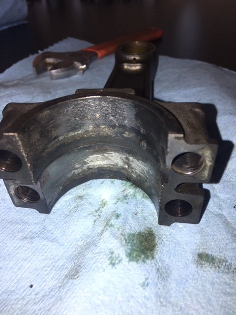

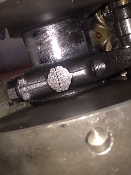

maxv11 Posted April 9, 2020 Author Posted April 9, 2020 Here is the crank. Again, I am positive this can be repaired but...I went another route.

po18guy Posted April 9, 2020 Posted April 9, 2020 5 hours ago, maxv11 said: Thanks mate, so I actually found a like new motor on eBay. 2004 Ballabio with only 3k on it! I purchased that last night and it will be shipped here. I plan to part out the current motor or sell it as a whole if anyone is interested. I will put up a listing in the Classifieds. Shoot me a PM if interested! Anyways...Below are pics of the damage. I am sure this could be repaired as I have dealt with this on other makes/models but honestly I wanted to do the swap. Some may disagree but it is what is best for my situation at this time. If I don't part out or sell this engine I'll keep it as a back up and have the crank rebuilt and possibly build up the motor into something sweet! Pete, do you still offer your plates? I feel I am inclined to install one on the new motor Thanks! Crap! I was just searching for that to post here - but it's gone! Who do you suppose…? 3877 miles IIRC. Far cheaper than a rebuild. For anyone who needs them, I did find this crank and rods from a Cafe Sport for $300 and change in Kali. https://www.ebay.com/itm/2004-03-05-Moto-Guzzi-V11-Cafe-Sport-OEM-Crankshaft-Connecting-Rods-Engine-Parts/324082671074?hash=item4b74d51de2:g:AmkAAOSw8iJeU2s5
gstallons Posted April 9, 2020 Posted April 9, 2020 This looks like a good deal . I would have a trusty machine shop inspect EVERYTHING before going together . I would use new rod bearings . Some use new rod bolts . Look at the main bearings too . When you reassemble , blow everything out w/air and use Lubriplate white grease when you go together . Keep the cam lifters indexed when you go back together and use a camshaft grease when you go together . 1

docc Posted April 10, 2020 Posted April 10, 2020 17 hours ago, pete roper said: The usual reason for these engines running their big ends is oil pick up exposure during hard acceleration. There is a fix for that. 1

po18guy Posted April 10, 2020 Posted April 10, 2020 Being a plain bearing motor, the bikes need a mercury switch to cut ignition if on their sides - but that would be just another nightmare for diagnostics. Went down twice in the 70s on my TX650 Yamaha. In one case, the bike was about 45º from being upside down in a ditch, but still idling. But since it is a roller bearing motor, it was not a huge deal. Went on to ride it another 30K or so.
