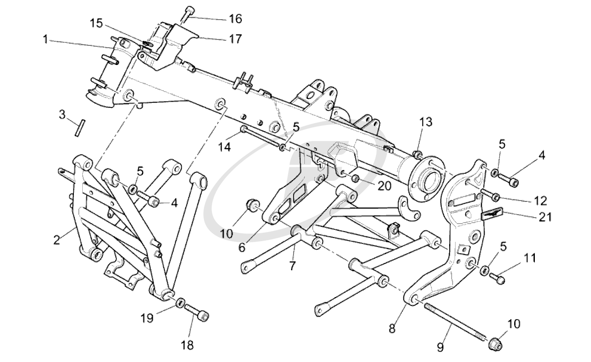

Grim Posted April 9, 2020 Posted April 9, 2020 Hello, Whilst continually nitpicking over my V11 in lockdown, I noticed I am missing a subframe to engine bolt, this wouldn't usually be a problem as I would just find out what it is and buy one; but as this is a 2003 sport it seems to have these mysterious aditional legs on the subframe (part 7 in the diagram) which no parts diagrams seem to have a reference to the bolt that actually holds this on. Looking on the other side, it is a large mushroom allen head bolt, but I don't want to remove the remaining one to check the size, anyone have any information? Thanks

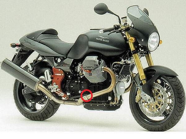

Grim Posted April 9, 2020 Author Posted April 9, 2020 10 minutes ago, gstallons said: I don't understand what you want . Is it part # 9 ? No, sorry for not being clear; it is the bolt that goes through the front arms of part 7, they are not listed as a part in any diagrams. (circled in photo)
gstallons Posted April 9, 2020 Posted April 9, 2020 It is a low profile socket head capscrew . It is a 12X35 1.75 thread pitch . there is a Schnorr washer along w/ Loctite . 2 1
Grim Posted April 9, 2020 Author Posted April 9, 2020 10 minutes ago, gstallons said: It is a low profile socket head capscrew . It is a 12X35 1.75 thread pitch . there is a Schnorr washer along w/ Loctite . Thank you so much. Is this knowledge through measuring it or am I missing a reference somewhere?
gstallons Posted April 9, 2020 Posted April 9, 2020 I unscrewed the capscrew from my bike and measured it . 7 1
Lucky Phil Posted April 10, 2020 Posted April 10, 2020 12 hours ago, gstallons said: It is a low profile socket head capscrew . It is a 12X35 1.75 thread pitch . there is a Schnorr washer along w/ Loctite . So 1 12mm x 35 x 1.75 button head cap screw grade 8, blue loctite and a washer. Cant really imagine why it would be 12mm screw, a 10 would have been more than adequate in my mind but that's Guzzi. Weight, what is this thing weight I wouldnt worry about the snoring washer if you cant source one, a plain one with the loctite will be fine. Ciao 2
