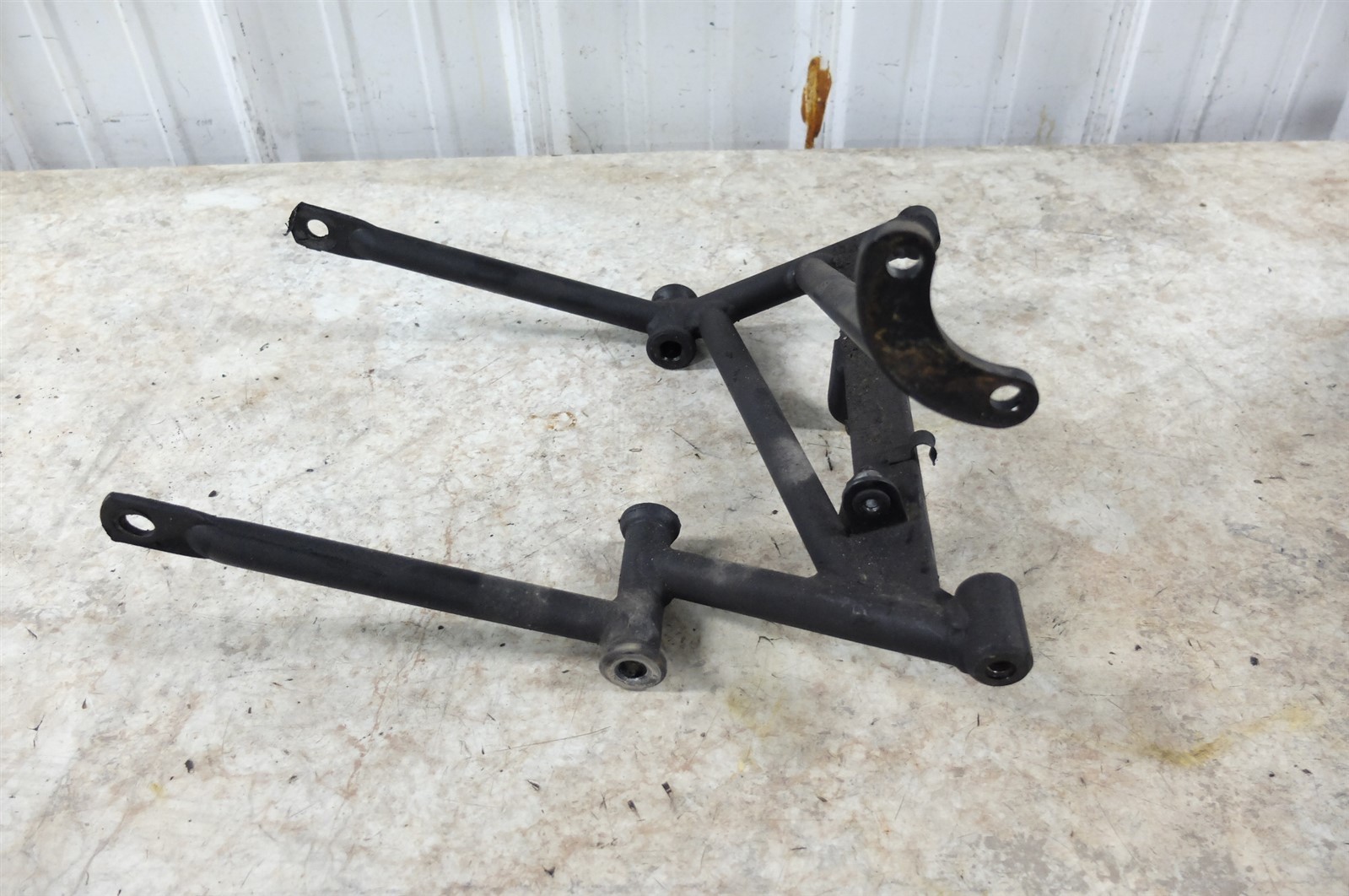

Tinus89 Posted April 14, 2020 Posted April 14, 2020 Glad she is OK! I did a similar thing on my black frame V11, left side as well, which cracked my gearbox directly adjacent the top rear mount. May want to check for that. Mine does not have the mid engine-gearbox-frame mount (well, it didn't then, it does now. And a new gearbox), I'm sure it would be fine if it has it. Â 1
docc Posted April 14, 2020 Posted April 14, 2020 1 hour ago, Tinus89 said: Glad she is OK! I did a similar thing on my black frame V11, left side as well, which cracked my gearbox directly adjacent the top rear mount. May want to check for that. Mine does not have the mid engine-gearbox-frame mount (well, it didn't then, it does now. And a new gearbox), I'm sure it would be fine if it has it. Â Good advice on checking for gearbox mount cracking. Happened to my Sport, as well. The center spine plate is fiddly to install, but worth mounting on the early RedFrame Sports. Later "LongFrames" like the Ballabio do not have the mounting point on the underside of the spine, but didn't you have to add that to your Rosso Mandello black ShortFrame, @Tinus89 ?
footgoose Posted April 15, 2020 Posted April 15, 2020 "mid engine-gearbox-frame mount "Â Â Â ??? you added this piece? Â Â
docc Posted April 15, 2020 Posted April 15, 2020 29 minutes ago, footgoose said: "mid engine-gearbox-frame mount "Â Â Â ??? you added this piece? Â Â Or, actually, this "frame plate"? Under the spine, mid-way, connecting to the junction of the back of the motor and front of the gearbox . . .
gstallons Posted April 15, 2020 Posted April 15, 2020 The frame plate fits the red frame ONLY . Trust me , I have an extra to prove it !
