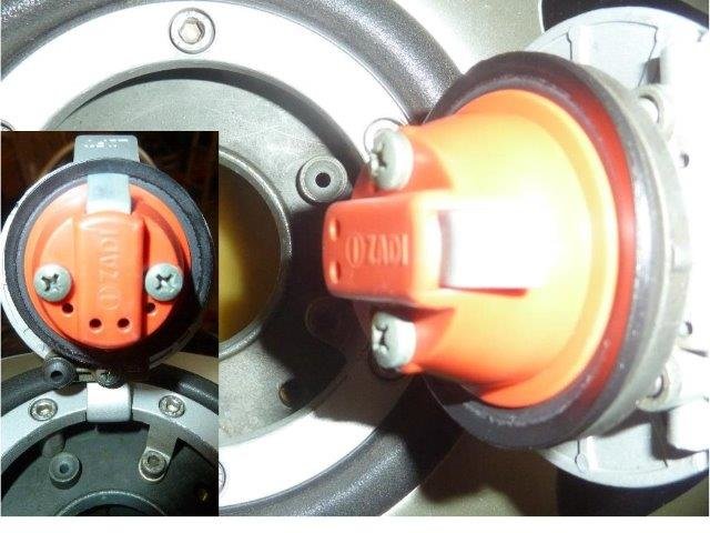

Nomorefours Posted April 15, 2020 Posted April 15, 2020 Hi, All New to this forum, and happy to find it! I bought a 2004 V11 Lemans Corsa Nero late last summer, and I have really enjoyed a handful of rides on it so far. Happily, the bike is in excellent condition, and runs very well, with just a couple of very minor issues... 1. If I fill the gas tank all the way, fuel 'weeps' out of the fuel cap and ends up on my riding pants...not so nice. Once it is lower than maybe 7/8 full, it no longer happens. This does not seem related to pressurization; I think the fuel is literally sloshing against the cap and getting past it when the level is high enough. The cap appears to function normally, BUT I have noticed there does not seem to be any 'rubber' seal. The cap has a metal ring that is spring loaded, and when closed this metal ring presses against a raised cream-coloured plastic lip. So it is metal against plastic, which does not seem like a great way to make a seal. Today I found some parts schematics online, but the fuel cap is only shown as a complete assembly. I cannot tell if there is a rubber ring missing on mine, or not. Searching photos online has been pretty fruitless. Can anyone tell me if there is supposed to be a rubber ring, probably attached to the steel ring on the cap itself, to make a proper seal? I have searched this forum, and found a reference to 'removing the rubber grommet on the cap' to solve tank pressurization / depressurization issues. Is it possible the former owner followed this advice, and would it be the same rubber ring I am wondering about? If my only resolution is to never fill the bike more than 7/8 full I guess I could live with it, but I would rather just have the cap seal and function properly. I also read about Oberon fuel caps, but could not find a specific part number or model (since their website does not list one for the V11 Guzzis). I don't really want to spend that $$ anyhow, when I can probably find a rubber ring at my local salvage yard (presumably from a different bike). 2. The bike has Mistral mufflers which look and sound fantastic, and as far as I know stock ECU and air box. It runs well, but *occasionally* stumbles around 3 - 4000 rpm. It is not consistent. Most of the time it does not stumble, just sometimes...but when it does, it is always around the same rpms. I have not been able to determine any other constancy like outdoor temperature, bike warmed up or not, or anything else. It just seems to randomly stumble around 3k - 4k on steady throttle. Any thoughts or comments related to the above, are most welcome! Thanks, Doug
MartyNZ Posted April 15, 2020 Posted April 15, 2020 4 hours ago, Nomorefours said: ...fuel 'weeps' out of the fuel cap... I cannot tell if there is a rubber ring missing... Hello Doug, My fuel cap has a rubber seal. See picture. The seal is 2.5mm thick, and when the cap is latched closed, it can be pushed down about 3mm and springs back when released. It is worth checking that the little vent seal beside the main seal is in place too. If the seal was removed to cure "tank suck", then you might want to make sure that drain hoses connected to two nipples under the tank are open, clear, and long enough to carry fuel and vapours away from the hot bits of the engine. Marty 1 1

Lucky Phil Posted April 15, 2020 Posted April 15, 2020 If you want an aftermarket cap you can use an Aprilia RSV unit. If you need a new seal I'd buy some sheet Viton or FKM from a rubber supplier of the right thickness and make your own. I see as you said they dont list a separate number for the seal. If you put some bearing blue or even some white enamel paint which you can immediately remove after on the tank sealing ridge or seal and close the cap then open it and look for marking you will be able to tell if its the seal not contacting. If the seal is making good contact then I would disassemble the cap and look for a problem in the cap vent. It should vent through the cap and into the round rubber seal that engages the round flange inside the cap assembly surround. In theory any fuel that gets into the cap surround area should be drained by the drain hose thats hooked up to it but it may be getting overwhelmed by a leak or the cap itself may be leaking internally and just dumping fuel out the top. Ciao
