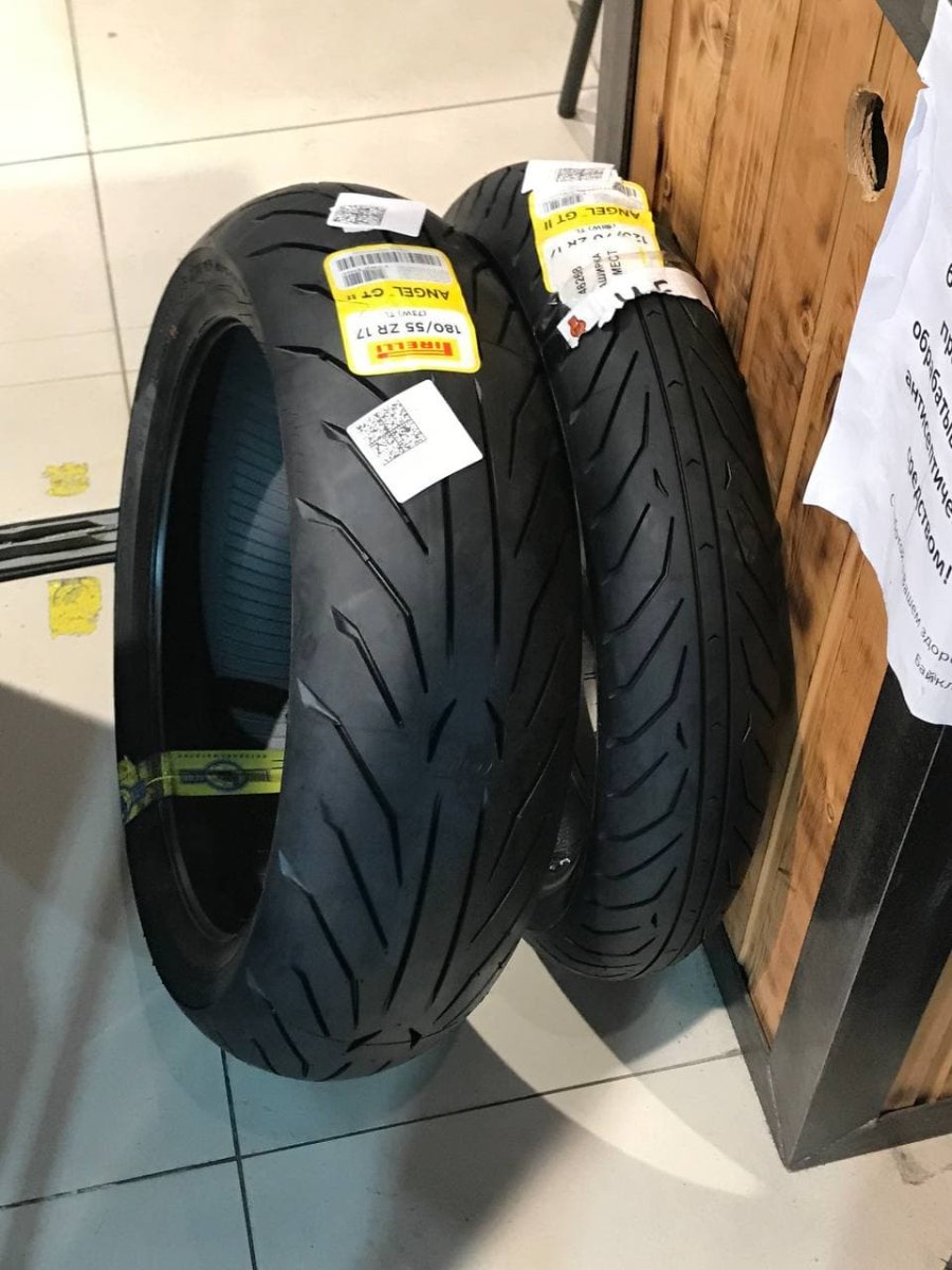

Dmitry_krysko Posted February 8, 2021 Posted February 8, 2021 Hi all. Today i buy new Angel GT Tyres for my Lemans v11 4
guzzler Posted February 8, 2021 Author Posted February 8, 2021 G'day mate. Let us know what you think of them after you've got a few K's on them. I found the very light steering a bit weird to start with especially as the first ride was in pretty ordinary conditions! But you get used to that pretty quickly and I do like them. Cheers Guzzler Ps oh they do track road imperfections a little ( read crappy road works - the car does it on the same stretch too! ) as noted by some but that doesn't bother me.
