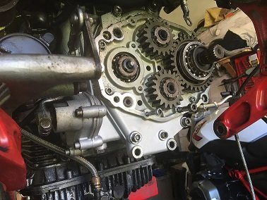

Steve S Posted April 24, 2020 Posted April 24, 2020 I'm trying to sell this Greenie and it's got an annoying gearbox oil leak that's putting buyers off, I removed the very back plate and the oil is coming from the next joint, before I dive in what's involved in removing the next plate behind the gears?
Tinus89 Posted April 24, 2020 Posted April 24, 2020 - Removal of transmission from engine - Untorque input hub transmission - Remove rear cover bolts and rear plate complete with all shafts comes out.
Steve S Posted April 24, 2020 Author Posted April 24, 2020 Thanks so the gearbox will need to be removed from the bike?
Chuck Posted April 24, 2020 Posted April 24, 2020 Since it's a Greenie.. it *may* be a cracked transmission mount. That is a known issue on the early red frames. Just the same, before I would go to all the trouble of pulling the transmission, I'd clean it very well and spray it with athlete's foot powder, baby powder, etc. Then.. you can see where the leak originates.
Steve S Posted April 24, 2020 Author Posted April 24, 2020 I've found the leak by putting some petrol in the gearbox and it leaks out of the second joint from the back quite low down so I'm sure it's not a cracked case, as the leak is so low down it leaks oil constantly onto the exhaust
