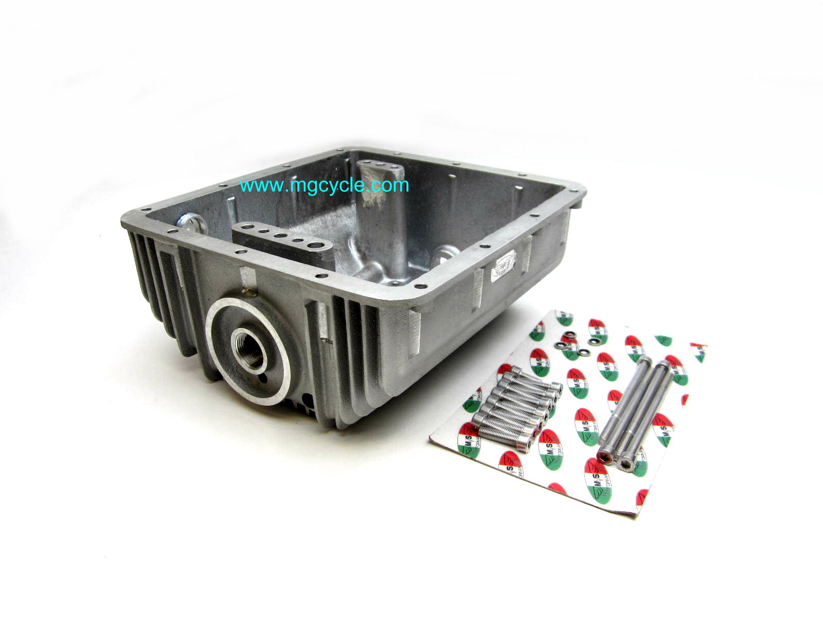

gstallons Posted May 14, 2020 Posted May 14, 2020 The design of the oil pan is not the best in the world . On vehicles , the pump pick-up is in a "dropped" part of the oil pan to prevent any kind of starvation . Windage trays , scrapers , etc. are built and used to keep as much of the oil at the bottom of the engine as possible .  we just need to understand this bike is not made to do some of the things we would LOVE it to do . 2
gstallons Posted May 15, 2020 Posted May 15, 2020  There was a deep sump pan being sold a few years ago for the V11 from a company in Germany ? Anyone recall ?
pete roper Posted May 16, 2020 Posted May 16, 2020 Probably the Moto Spezial 'V' sump. From memory it deleted the oil cooler but it did have the pick-up cast in to the bottom of the 'V' so exposing it was pretty difficult. When the CARC bike's were launched Guzzi actually said that the sump had been re-designed to prevent pick up exposure, (Although it was hidden way down in some press release. Heaven forbid they admit that the earlier design was shite!). The later system the pick up, although it still comes down from above, sits slightly recessed in the casting and has a cast in weir behind it to discourage the rearward slop of oil. It seems to work as I haven't heard of anybody having the 'Flickering oil light of death' on a CARC bike. 2
Lucky Phil Posted May 16, 2020 Posted May 16, 2020 This one Pete? It's very nice but you need an external filter adaptor to run an oil cooler which is what Paul Minnaert has done. It's also got a sight glass which is nice. The other thing is on a V11 the small side stand support bolt wont work. I seem to recall Paul mentioned that the daytonas didnt have the smaller mount bolt anyway and nor does his bike.Personally I'd prefer the small bolt as well and thats what's stopped me buying one for years. Interestingly even with the extra capacity Paul says the Daytona's still needs an oil cooler even in European summer traffic. Ciao    Â
Belair63 Posted May 17, 2020 Posted May 17, 2020 An unkown previous owner installed, verified existence when I serviced after purchase.  Thanks Mr. Roper, very impressed with with your design and workmanship. Have never seen the light flash /solid when accelerating.  Ride safe folks!Â
pete roper Posted May 17, 2020 Posted May 17, 2020 9 hours ago, Lucky Phil said: This one Pete? It's very nice but you need an external filter adaptor to run an oil cooler which is what Paul Minnaert has done. It's also got a sight glass which is nice. The other thing is on a V11 the small side stand support bolt wont work. I seem to recall Paul mentioned that the daytonas didnt have the smaller mount bolt anyway and nor does his bike.Personally I'd prefer the small bolt as well and thats what's stopped me buying one for years. Interestingly even with the extra capacity Paul says the Daytona's still needs an oil cooler even in European summer traffic. Ciao     And the funny thing is that the Nuovo Hi-Cam runs absurdly cool because it has a separate cooling circuit that doesn't have a thermostat! theycouldnt run a brothel in an army camp!😂 1
