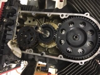

andy york Posted April 6, 2022 Posted April 6, 2022 Well well well Houston I have a conundrum. Crank and cam gears aligned upon disassembly. This is where I'm at cam sprocket is on the dowel pin...crank sprocket is on the woodruff keyway. what to do.... 1
docc Posted April 6, 2022 Posted April 6, 2022 Is the motor TDC on the right cylinder, or just stopped randomly? 1
Lucky Phil Posted April 6, 2022 Posted April 6, 2022 The crank has moved. Look at the keway on my install compared to yours. Make sure you rotate the engine by hand with the plugs out to check for interference before you button it up. Ciao 1
po18guy Posted April 6, 2022 Posted April 6, 2022 Yeah, pull one gear and rotate the crank until the marks line up. If the plugs are in, it prolly ain't at TDC. In any event, after the install, rotate the crank verrrrry slowly, listening and feeling for interference.
Pressureangle Posted April 6, 2022 Posted April 6, 2022 Seems like mebby I saw this with mine... The hole in my memory says maybe they're timed on the other cylinder. Don't trust anything in my memory hole. In any case, just line them up and trust it's right.
docc Posted April 6, 2022 Posted April 6, 2022 3 minutes ago, andy york said: This seems mo better What was the issue/solution?
andy york Posted April 6, 2022 Posted April 6, 2022 I haven't rotated it over yet....these engines turn easy with no plugs in. TDC ....S in the flywheel hole...dots line up ....dinner .. then I will go rotate it a couple times. this is some really nice kit. I had no appreciable wear on the cam thrust bearing....the old one measured 7mm thick and the new one was 7mm thick. lock washer behind oil pump nut was broken in two.? 1
docc Posted April 6, 2022 Posted April 6, 2022 So, TDC/ sinestra! These replaced your original (~130,000 mile) chain and tensioner? How did those look coming out? Also, Joe would like to know what you found for residue/ "sludge" in the bottom of the timing chest pool?
andy york Posted April 6, 2022 Posted April 6, 2022 no sludge in my motor not having a new set of sprockets to compare, I could see some wear....nothing worthy of you-tube. I'm very pleased with the look of everything after 130,000 miles 1
