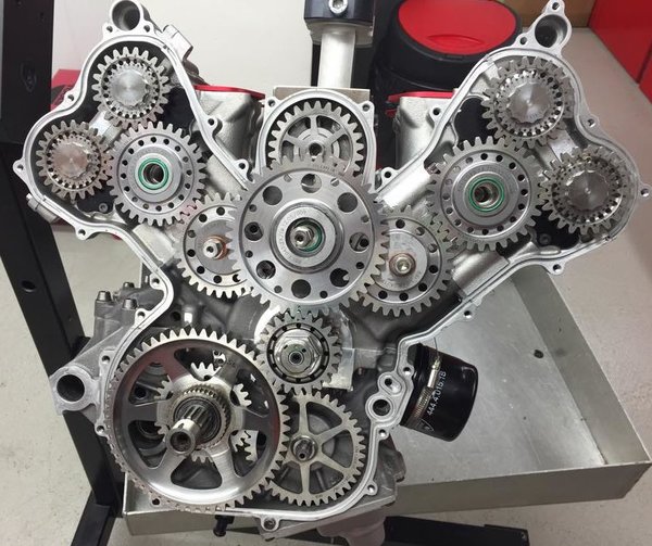

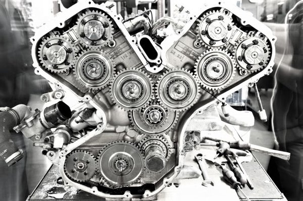

Lucky Phil Posted May 1, 2020 Posted May 1, 2020 Just came across this article. Looks like Kevin and I are on the same page. https://www.cycleworld.com/story/bikes/about-motorcycle-engine-cam-drive-systems/ Ciao 1
po18guy Posted May 1, 2020 Posted May 1, 2020 Love the straight-cut gear whine. The price for such a limited edition, custom set, not so much. So, maybe the upgraded cam chain adjuster and we'll call it good.
80CX100 Posted May 1, 2020 Posted May 1, 2020 Hey Phil, Tks for posting the article and the photos The innards on some of those engines are like beautiful works of art. It's hard to believe that something that looks like the workings of a fine Swiss watch, can power a race bike , screaming around a track. Kelly 1
Lucky Phil Posted May 1, 2020 Posted May 1, 2020 10 hours ago, 80CX100 said: Hey Phil, Tks for posting the article and the photos The innards on some of those engines are like beautiful works of art. It's hard to believe that something that looks like the workings of a fine Swiss watch, can power a race bike , screaming around a track. Kelly Yes it's engineering art. I love engineering, it's science and engineering together that's propelled mankind to where we are now. I was watching a doco the other night on the building of the English canal system in the 18th and 19th century and the men that engineered it and any of those great engineers from back then would be brilliant engineers today as well if you could resurrect them. Ciao 2
