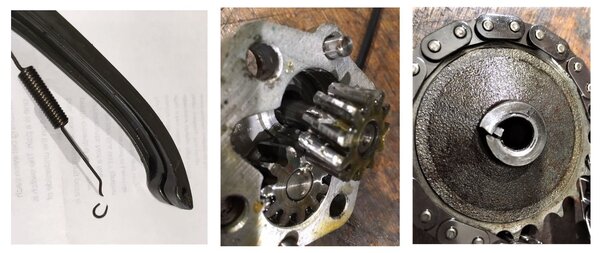

Lucky Phil Posted July 18, 2021 Posted July 18, 2021 Here's an interesting image of a 1 year old blade style tensioner failure. Nasty collateral. Ciao 1 4
Pressureangle Posted July 18, 2021 Posted July 18, 2021 On 7/18/2021 at 12:31 PM, Lucky Phil said: Here's an interesting image of a 1 year old blade style tensioner failure. Nasty collateral. Ciao Expand I sort of wish I hadn't seen that. I know you're a huge fan of gears, and so am I. Now even moreso. How did that bit get past the screen into the pump?

80CX100 Posted July 18, 2021 Posted July 18, 2021 On 7/18/2021 at 12:31 PM, Lucky Phil said: Here's an interesting image of a 1 year old blade style tensioner failure. Nasty collateral. Ciao Expand It's hard to tell from the photos (scarey), but if that failure was in the area of the little metal rod anchoring the spring to the plastic body, it's definitely the weak link of the design. My first one broke right there, on installation. I'm surmising that tensioner was probably cracked during installation, then failed during use? idk When I replaced the timing chain on my CX100, I had read about how trying to get the blade tensioner into place could be a bit of a biatch; many posters talked of how "just use a little more force to manhandle it into position, it's well made and strong, it won't break" I took their posted advice to heart, and managed to prove them wrong, as I used just enough force to watch my new ValTek tensioner break, while trying to get it installed. I used much more finesse the second go round,lol. It's only plastic, obviously not as bullet proof as I'd like, fwiw.

Lucky Phil Posted July 18, 2021 Posted July 18, 2021 On 7/18/2021 at 12:34 PM, Pressureangle said: I sort of wish I hadn't seen that. I know you're a huge fan of gears, and so am I. Now even moreso. How did that bit get past the screen into the pump? Expand It didn't. I'd say the failed tensioner resulted in total loss of cam chain control which then caused the oil pump and drive gear failure. Ciao 1 2
