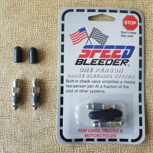

Vic Posted May 15, 2020 Posted May 15, 2020 I came across these ,and wondered if anyone has used them,they seem like a great idea. I guess they have been around for a while, but I hadn't heard of them till yesterday. Think I'll give them a try, but I was wondering if anyone else has had any luck with them. Thanks for any input. 1
gstallons Posted May 15, 2020 Posted May 15, 2020 I haven't used them . They are a good idea . Go ahead and use them , they should be ok .
Pressureangle Posted May 15, 2020 Posted May 15, 2020 I have a couple sets, metric and SAE. They're awesome. The only thing you have to mind is if you've drained the entire system, or run new empty lines, they have enough resistance that you may not be able to compress the air in the lines with the master cylinder. Probably not even a potential problem on a motorcycle. They work as advertised, and best part is they don't drip all over when you gravity bleed.

68C Posted May 16, 2020 Posted May 16, 2020 Tried the speed bleeders many years ago, good idea in theory. After a time it is common for bleed nipples to become tight and difficult to remove, the problem with these is they seem to be weaker than standard nipples and shear off easily. This is probably due to the larger hole needed to accommodate the valve. Once sheared off difficult to remove as the hardened valve spindle makes it difficult to drill accurately for an eezy out stud remover. 1 1
Weegie Posted May 16, 2020 Posted May 16, 2020 Tried them in the past, but not on Guzzis, but they never really worked for me. I use a Mityvac that I've had forever and like, the Power Bleeder kit looks good too. Like Phil I try to do it every other year (doesn't always happen though) Never found it that difficult to do, some are easier than others, especially if you empty the circuit (rear brake and the hydro clutch on the Ducati can be a bit of a pain). If you're just pulling fluid through until its clean it's not hard at all. I try to exercise the circuit by using the lever to get all the pistons moving and get rid of as much of the old fluid out as possible. If still not satisfied I'll drain it down then bleed through fresh fluid for a few fills then nip up the bleed screws. You'll know by feel when there's no air in the circuit anyway.
