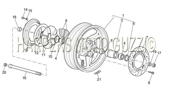

I was studying the exploded parts view for the rear wheel (Pg. 35 of the V11 parts manual, 2003-2004 flavor) while waiting for a rear tire delivery and noticed the item 10 O-ring, PN 90706490. If I'm reading this correctly, it resides about the outboard face of the RH wheel bearing and, if present, should be visible once the wheel is off. I've never seen it. Do I have this right, or is it embedded in the Item 11 (flexible coupling disc), 12 (Ring), and 13 (Flange) assembly?

" . . .  embedded in the Item 11 (flexible coupling disc), 12 (Ring), and 13 (Flange) assembly . . ."
This is my recollection. So, not visible with the wheel off. Part of the "cush drive."
A picture of the O-ring, so as Docc said, part of the "cush drive".
This picture shows the standard V11 configuration, with all 12 undrilled rubber pucks
