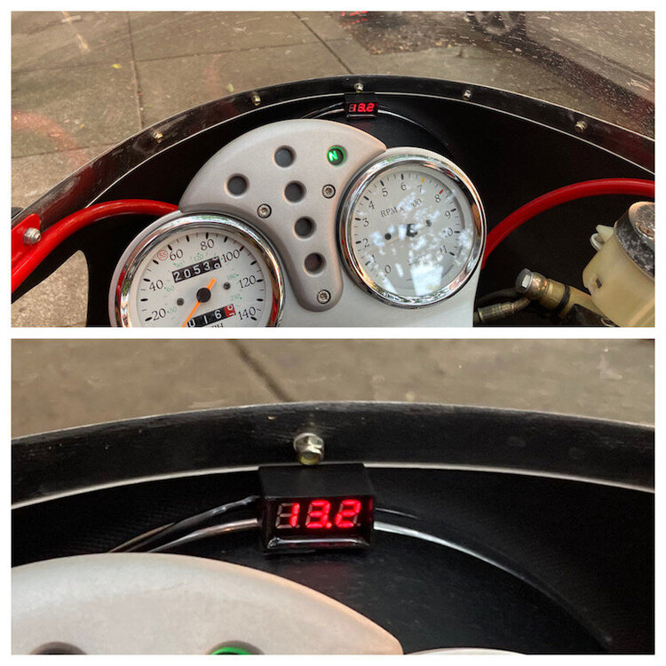

jtucker Posted August 13, 2020 Posted August 13, 2020 I had this same problem recently, that left me stranded a handful of miles from home. Then it left me stranded again (after I fixed the wrong problem LOL). Then it almost left me stranded a 3rd time when the fix (soldering job) decided to un-fix itself. Finally, the stator was replaced and all was right in the world again. The frustrating part of it was that the charging "idiot light" was true to its name, and acted like an idiot - either not lighting up at all, or briefly coming on and going out again a short time later. This, combined with my general disdain for idiot lights, prompted me to wire up a compact volt meter I got from Aerostitch. Hopefully, no more surprises in the future. __Jason 2 1
