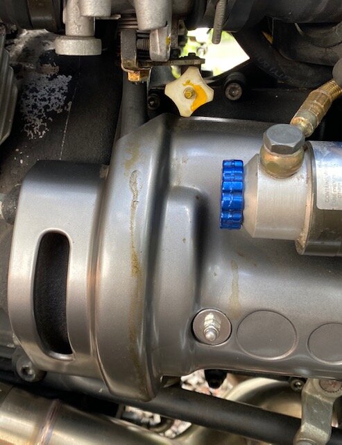

Gmc28 Posted July 28, 2020 Posted July 28, 2020 this is probably something i should already know, but i don't.... i have this seepage coming from left throttle body, leaving the fuel goo on the left side alt cover. is it something to just wipe off and ignore, or is it indicative of an issue that should be addressed in the throttle body? fishing for easy answers during the prime riding season, when i'm much less likely to fiddle and more likely to just ride, which then flips around to the opposite scenario in the wet season. So much riding to be done, so little time...
docc Posted July 28, 2020 Posted July 28, 2020 Yep, "they do that." Made worse if we pressurize the system briefly (switching the fuel pump on and off, or brief start-ups). Otherwise, there are procedures to address the throttle shaft and sealing O-rings. 1 1
Gmc28 Posted July 28, 2020 Author Posted July 28, 2020 Thanks Docc-Then I shall ride on in bliss, and re-visit it in winter.
paulnaz Posted July 28, 2020 Posted July 28, 2020 Gmc28, Back in 2014 over on Wild Guzzi, Bill Havins did an extended write up on relacing the seals and cleaning the injectors and throttle bodies. A search over there will reveal all. Paul B 2

gstallons Posted July 29, 2020 Posted July 29, 2020 loosen the air filter to throttle body hose and push it back into the air cleaner housing . Open the throttle body to wide open . Turn the key on to pressurize the fuel system . watch to see if the fuel leaks from the injector or the injector to the throttle body seal . Then decide what to do . 2
Lucky Phil Posted July 29, 2020 Posted July 29, 2020 The issue with the throttle bodies leaking fuel is that on a Guzzi the throttle shafts are vertical and any fuel that pools in the throttle bodies like when you cycle the ignition and it squirts a prime shot into the inlets or if it doesn't start, sits there and leaks down the shaft through the worn shaft bushes and onto the worn seals. Most engines dont have their throttle shafts vertical so it's not as much of an issue. The solution is to replace the shaft bushes which I have just done and replace the seals which I'm waiting to show up in the post. I managed to source the original brand and type of bush Weber used and the seal is a part from another motorcycle brand. Ciao 1
