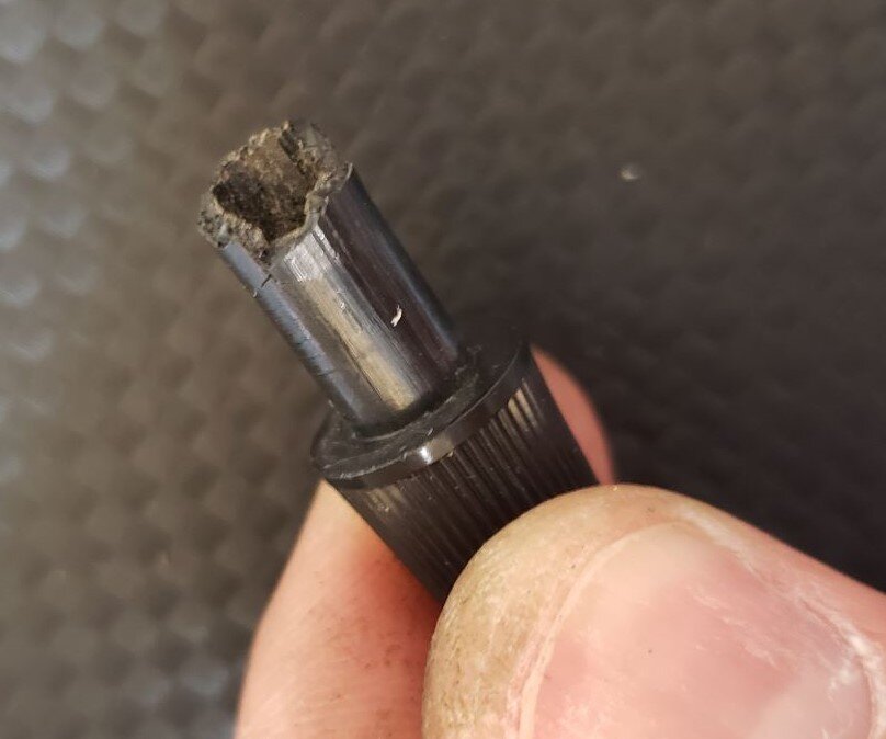

daviscr5 Posted August 8, 2020 Author Posted August 8, 2020 Hello all, I just pulled my speedo to send to Joel Levine (odo and tripmeter don't work). Funny that the reset knob was badly broken for some reason. I'll need to find a replacement and have asked Joel if he can replace. Also, the rubber boots that hold each little lightbulb were real buggers to get out of the housing. Any suggestions on how to get them back in once I receive the speedo back?

Steve S Posted August 10, 2020 Posted August 10, 2020 On 8/9/2020 at 1:04 AM, daviscr5 said: Look what I found: https://www.mgcycle.com/index.php?main_page=product_info&cPath=73&products_id=134 That wouldn't fit the ITI speedo on the V11, it has a thread like the early Veglia speedo the ITI knob has a tiny screw securing it 1 1
daviscr5 Posted August 10, 2020 Author Posted August 10, 2020 Guys, I've corresponded with Joel Levine: www.joellevinecompany.com. Says he can do them for $295 which includes a 1-year warranty. He was recommended from this forum. Shipping today, will let you know how it goes. 2 1

Tom in Virginia Posted August 20, 2020 Posted August 20, 2020 On 8/10/2020 at 9:41 AM, daviscr5 said: Guys, I've corresponded with Joel Levine: www.joellevinecompany.com. Says he can do them for $295 which includes a 1-year warranty. He was recommended from this forum. Shipping today, will let you know how it goes. I've think I have a knob in good shape. I just have to put my hands on it. I sent the old odo to a guy in Canada for some R&D he was gonna do on his ITI gage. My odo/speedo is now a (duR) from TLM so no use for it.
daviscr5 Posted August 22, 2020 Author Posted August 22, 2020 On 8/20/2020 at 8:29 AM, Tom in Virginia said: Does this look like it? Tom, yes that looks to be the same knob as the one MG Cycles shipped me. That said, when Joel called me to report my speedo was ready to ship he also offered to make me a new knob which I agreed to. This way I know I have a solution and the backup knob from MG. Will let you guys know how it all works out.
