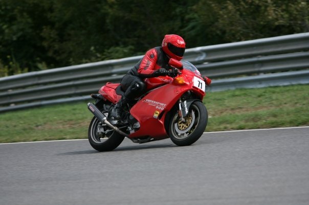

4corsa Posted August 7, 2020 Author Posted August 7, 2020 I agree, I'm not really worried about the oil performance. What I am concerned about is a repeat of what happened to my first air-cooled bike - a '95 Ducati 900SS/SP. Many years ago on an 85° day I was leaving Port Jefferson shortly after the ferry arrived and was stuck behind 50 cars and a series of 4 or 5 stop lights. 10 minutes later when we finally got through the last light and got moving, my buddy pulls along side of me and starts pointing at the back of my bike. We pull over and he tells me I have blue smoke coming out of one of my exhausts. Long story short, turns out that the rear aluminum cylinder (the rear always runs hotter on Ducatis due to less ventilation) warped due to overheating. The bore became slightly ovalized which allowed oil to bypass at the two new long ends of the oval. The '95 and earlier 900SS did not have an oil gauge and the overheating warning light never came on. I have no idea what the oil temp got to that day. So, I'm more concerned about the heat causing warpage than the oil breaking down. 2
