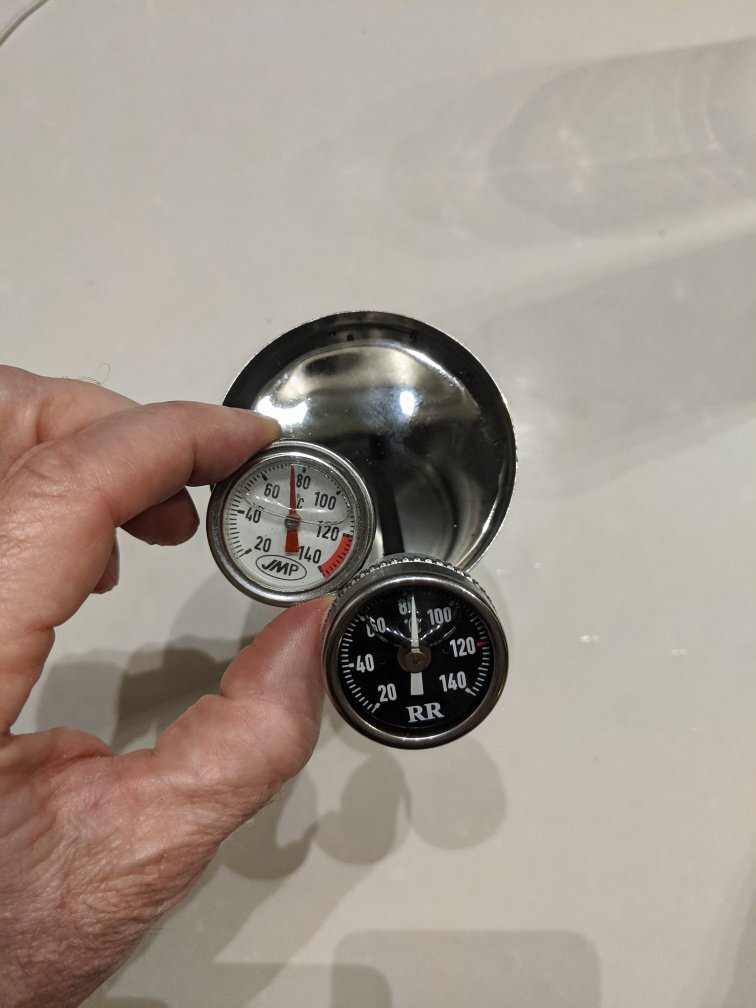

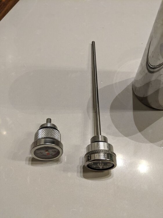

4corsa Posted August 8, 2020 Author Posted August 8, 2020 On 8/8/2020 at 12:21 AM, po18guy said: All transverse crank twins, V or L, have at least some cooling issues under some circumstances. Back in the mid 60s, it was substantially worse due to poor oil in comparison with what we run today. At some point, that might (or might not)_ have occurred to Guzzi engineers. And, those big jugs radiate heat 360º in addition to the oil cooler. Do let us know what boiling water tests reveal as far as the readings of those two gauges. Expand Ok - here you go. The gauges are different manufacturers, and the Guzzi stem is about 8" long and one for the Duc is only about 1". As you can see, there is about a 4°C difference between the two, the Guzzi gauge being the higher of the two. Makes me feel a little better. 1

Lucky Phil Posted August 8, 2020 Posted August 8, 2020 On 8/8/2020 at 1:28 AM, 4corsa said: Ok - here you go. The gauges are different manufacturers, and the Guzzi stem is about 8" long and one for the Duc is only about 1". As you can see, there is about a 4°C difference between the two, the Guzzi gauge being the higher of the two. Makes me feel a little better. Expand Looks more like 6-8deg? or is there parallax error. Ciao
