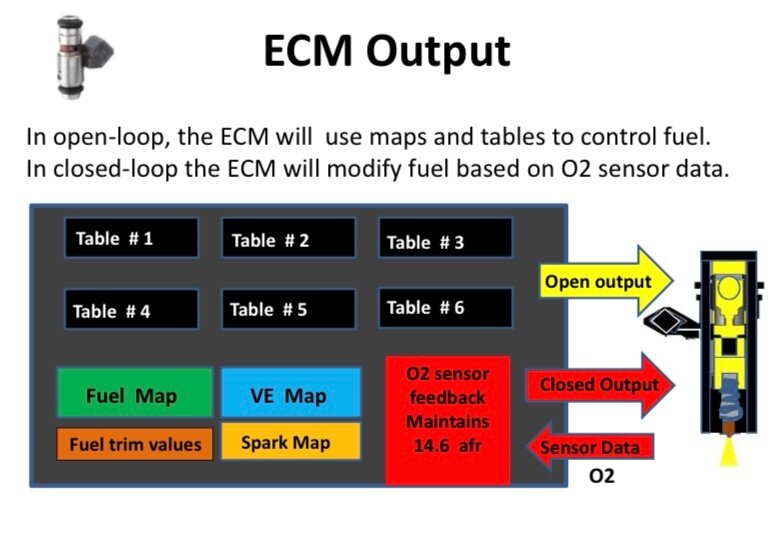

Weegie Posted January 4, 2022 Posted January 4, 2022 Reading this just out of interest as I don't own a V11. Just a couple of stupid questions, from the thread I gather that there are 2 Lambdas installed, in the headers? Are these wide or narrow band? I've got an 2017 R9T and I've installed a full Zard system, so bye bye cat. The R9T MAY run a little lean without the cat, opinion varies, the system is (allegedly) closed loop and the sensors are narrow band. I've installed a RapidBike Evo, this will adaptive tune using the narrow band over a few hundred miles to an adjustable AFR set by the user, if required, it also allows some other fuel tweaks and you can tinker with the map. To get the very best from the system though, a wideband Lambda can be used and the tuning is "real time" (I know there isn't really such a thing). With the wideband, the Evo knows where the AFR is and can target fuelling quicker AFAIK narrow band Lamda acts more like a switch and wideband returns a value over a wider range I'm guessing the Lambdas in the Guzzi are narrow band but wondered out of interest. Oh and I'm pretty ignorant about this whole thing knowing only the basics, but trying to educate my aging brain, probably a losing battle.
