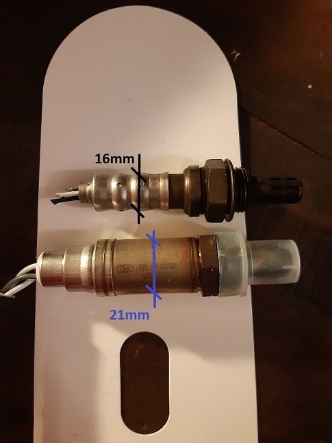

Miro Kacur Posted September 2, 2022 Posted September 2, 2022 Hi all, What is your experience in fitting the Bosch LSH24 0258003805 sensor in place of the original O2 sensor? I have a 2003 Ballabio with closed loop O2 sensor and original exhaust. I have discovered that the original O2 sensor was faulty so I am in the process of replacement. I was following the recommendations of ScuRoo here on this thread I acquired the Bosch LSH24 0258003805 sensor, however, the Bosch LSH24 sensor has slighly wider collar and I am not sure if it fits in the exhaust hole. The collar is simply too wide in diameter and is pushing against the frame bar. Please see the pictures for better explanation. The original O2 sensor collar is 16 mm in diameter and the Bosch LSH24 0258003805 sensor is 21 mm. Anybody experiencing the same problem and if so what was your remedy? 1

ScuRoo Posted September 3, 2022 Author Posted September 3, 2022 On 8/20/2020 at 10:46 PM, ScuRoo said: Okay... before I go further - on my bike the O2 sensor site was relocated on the left header just in front of the oil dipstick when a MassMoto X-over was installed. The existing O2 sensor was just rerouted to that location. My sensor bung site was relocated when I installed my MassMoto crossover Miro Kacur. With regards to yours abutting the frame the width difference is effectively 2.5mm wider each side than your stock sensor - I’m guessing it’s lightly touching otherwise you wouldn’t have been able to line it up & screw it in otherwise. Although I agree touching is not ideal. So what to do as a solution? Well, in the first instance I’d probably release all the clamps around the stock collector joining the stock pipes & tug & pull, yank & twist to try & gain an extra 1 or 2mm of clearance if possible. Swearing & banging with & rubber mallet might help too! Maybe even give it a start & some blipping revs or short ride with those pipe joints loose & try to bang squeeze some sort of wedge in there like a hacksaw blade - hopefully any engine twisting in frame with loose joint will help some readjustment. Then after tightening pipe joints remove wedge & hopefully have some sort of resettlement with 1 or 2mm clearance. Bush fixes I’d try first. If all that malarkey fails just get new bung fitted wherever you’d think appropriate. On my relocation site choice I researched first that O2 sensors should be reasonably close to exhaust valve exit - from memory I think it was recommended like 12-18 inches - but you can check. They like a hot temperature environment - & with no possibility of contamination of outside air from end pipe ingress. Finally imo - I’d worry less than you & being happy I’d simply managed to screw it in place - just plug in & go ride as is & test the new differences to your bike. It’s your call MK in best routes to alleviating the frame rub I’m looking forward to your report back on your bikes behaviour 👍😎 Ps. Mine after long period of time now - remains completely smooth & 100% hiccup snatch free Totally recommend for 15RC fitted V11’s 1

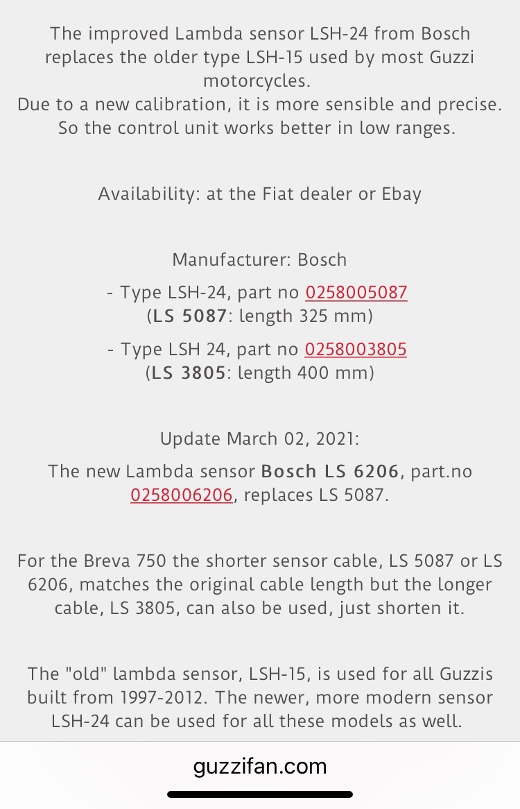

ScuRoo Posted September 3, 2022 Author Posted September 3, 2022 https://www.guzzifan.com/moto-guzzi-tuning-codes-infos-tips/ Also recommended: After install for the first two rides on seperate days an adaptation procedure was followed: 1. Start engine & allow to idle for 5 minutes. 2. Drive vehicle for 5 minutes between 20 & 30 MPH. Do not allow RPM’s to exceed 3000 RPM’s. 3. Drive vehicle for 15 minutes between 40 & 60 MPH. Do not allow RPM’s to exceed 3000 RPM’s. 4. Stop vehicle & allow to idle for 5 minutes. 1 1

Miro Kacur Posted September 11, 2022 Posted September 11, 2022 On 9/3/2022 at 2:32 PM, Miro Kacur said: Thanks, I will evaluate the options and let you all know which one worked out for me Dear All, After weighing all the options I found the most feasible solution to replace the faulty stock O2 sensor with the BOSCH Type LSH 24, LS 6206, part.no 0258006206, length 325 mm The „collar“ of the above mentioned sensor is 18mm which is slightly wider than the original stock sensor’s 16mm (for full details see my post from Sep 2 above), nevertheless, it fits in the place. I don’t have any info about actual performance because I need to reassemble the rear drive, put the wheel back, etc… So to recap -> if you are to replace your stock O2 sensor on V11 Ballabio 2004 (in the post above I have wrongly stated that I have Ballabio 2003, but in fact I have 2004) with stock cross-over, you might have to opt for the BOSCH Type LSH 24, LS 6206, part.no 0258006206, length 325 mm which is the one that can fit in the tight space and does not interfere with the engine block frame. Miro 2 1
