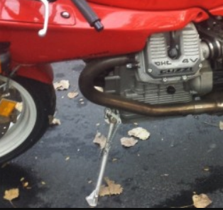

jtucker Posted August 26, 2020 Posted August 26, 2020 Daytonas and Sport 1100 also had auto-retracting stands, as can be seen in the attached photo. This is the same type of stand I have on my V11S now, due to the standard V11 stand not fitting the deep-V sump. Personally, I do not like the auto-retract feature - especially due to the fact that I live in a city where the odds of someone (either intentionally or otherwise) bumping your bike could result in the sidestand retracting unexpectedly and the bike falling over. Instead, I'm in the habit of reaching down and raising/lowering the sidestand by-hand, which allows me to guide the spring past the bolt head where it usually catches. PITA? A bit... but I'm used to it. __Jason
