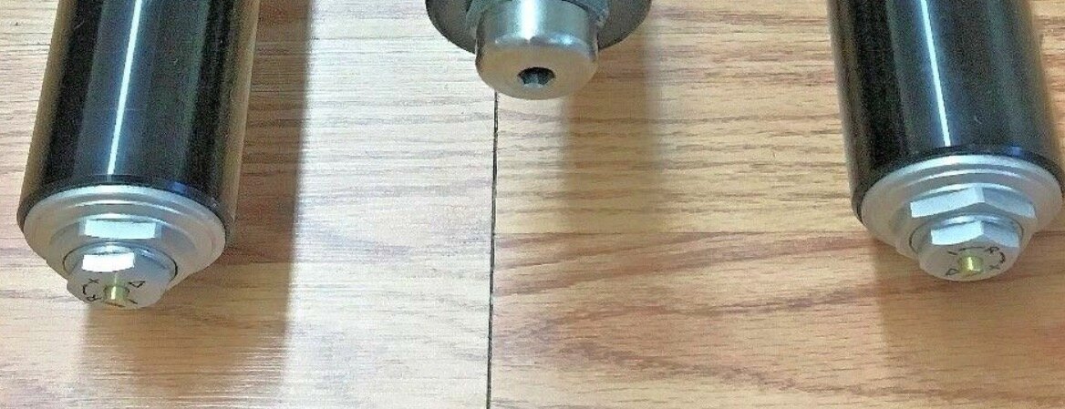

jtucker Posted September 8, 2020 Posted September 8, 2020 Interestingly, this:https://www.ebay.com/itm/1999-2004-Moto-Guzzi-V11-Ballabio-Complete-Front-Fork-GU01490280/362402336724?epid=13021999341&hash=item5460dccfd4:g:M5QAAOSwyglbYOlK Shows the same... both forks are marked "R" only: Not sure that really solves anything, but... 🤷♂️ __Jason 1
andy york Posted September 8, 2020 Posted September 8, 2020 it may not solve the issue but to me it puts more cred on the fact that the smaller hex nut is for compression. and if that is the case you will have to take off the top cap to adjust your sag. some forks you can "feel" the detents as you turn the rebound screw. I would think that there are no more than 15 on the Marz. There maybe detents on the compression.make a mark with a sharpie, put a box end wrench on the smaller nut and see how many turns. If you ever get to the point of pulling the forks out, upon reassembly, be sure to index the forks to the same orientation so your markings make sense. like put the R on "top"

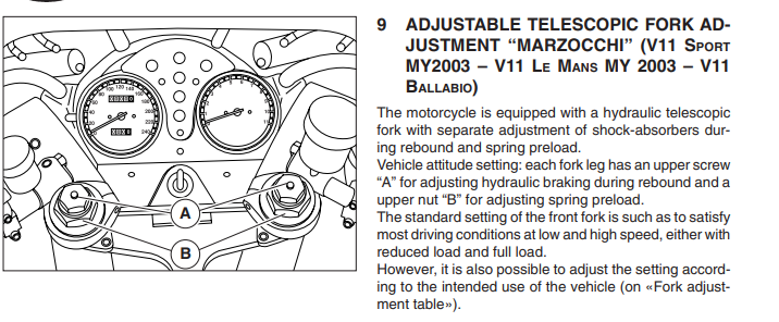

Lucky Phil Posted September 8, 2020 Posted September 8, 2020 25 minutes ago, HantsV11LeMans said: Thanks, They look like mine (at least at the top) it’s dark now in the UK so I’ll compare the rest in the light. It’s going to my local mechanic Thursday for a new fuel filter, I’ll show him all of this helpful detective work. We’ll count click on detents and revolutions on the smaller hex nut. He may change the standard sae 10 fork oil to sae 5 to see if that helps with sag if there is no adjustment aside from spacers. thanks to you all, really. I’ll keep checking for info and advice. I’ll update Thursday too. Maybe I should just wear a heavy backpack to beef myself up. When in doubt look at the shop manual. Looks like you have an earlier owners manual. The transition of components for Guzzi isn't a hard line and so neither will be the owners manuals. Ciao 1 2
footgoose Posted September 8, 2020 Posted September 8, 2020 Yes, you have an early riders manual. I checked my stash of stuff and found this one. 1

jtucker Posted September 9, 2020 Posted September 9, 2020 The (updated) manual page that was posted seems to say that there is no compression damping adjustment - only rebound damping and spring preload. If that's the case, then it seems changing oil viscosity is about the only way to adjust compression damping (which would, in turn, also affect rebound damping). I hate to say it, but if you want to really be able to fine-tune, you might want to consider an improved cartridge, such as: https://www.omniaracing.net/en/andreani-misano-evo-adjustable-hydraulic-cartridge-for-moto-guzzi-v11-mans-20012006-p-43777.html __Jason
