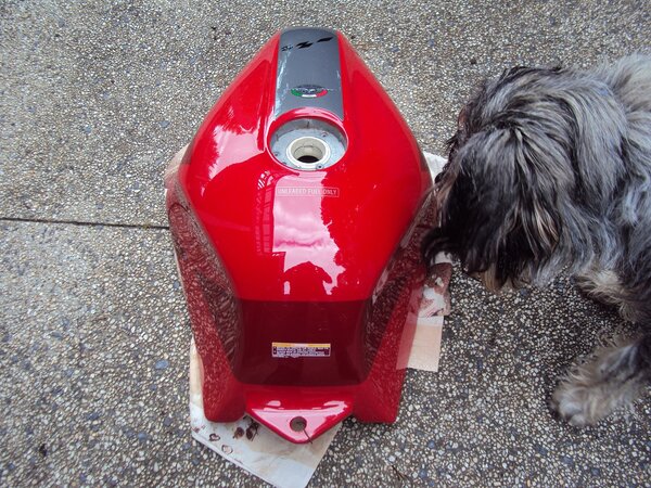

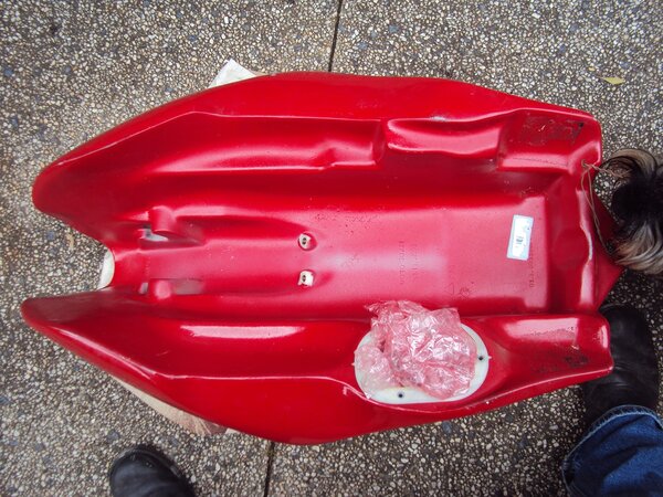

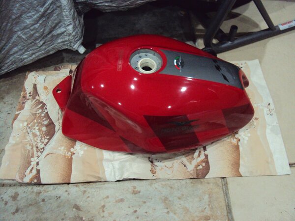

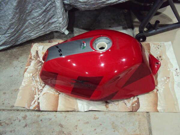

Lucky Phil Posted September 27, 2020 Posted September 27, 2020 57 minutes ago, Shepflylow said: Hello Phil. If it is a Rosso Corsa model it’s a deal. Could you send me an email and we can figure out shipping and payment? I’ll figure out with my shop how to get it restored, and it will be nice to keep my original for reference I'll get it out and post some images. This tanks paint is actually close to perfect. Certainly any minor blemishes can be addressed with a hand cut and polish of the clear coat. Looking inside the tank I dont even know if its ever had fuel in it. I bought it years ago and never used it. It will also need a pair of 30103730 vent fittings. There is a pair on ebay USA now for $15 new. Item # 324118401061 PM me and if your interested we'll work something out. I'm guessing the postage may well be around $100US as well. Merlins defect inspection......Pass Ciao 1
