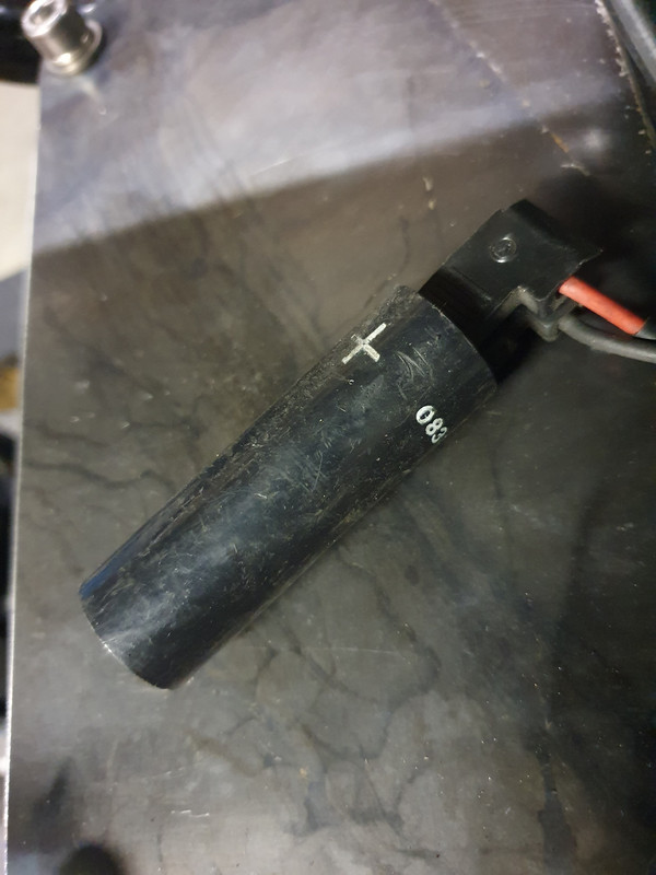

Tinus89 Posted October 6, 2020 Author Posted October 6, 2020 Awesome... Anyone who can shine a light on which part this is and it's function? I can't locate it on the wiring diagram... Edit: it is a part on my V65 Florida, not the V11...
Kiwi_Roy Posted October 6, 2020 Posted October 6, 2020 30 minutes ago, Tinus89 said: Awesome... Anyone who can shine a light on which part this is and it's function? I can't locate it on the wiring diagram... Its hard to know I can't judge the size, is it possibly the coil for an electric petcock http://www.thisoldtractor.com/guzzi007/schematics/1999_V11_sport.gif item 32 Does the red wire come from Fuse 8? Owners sometimes remove the electric valve and replace with a manual petcock. What is the complete part No we can see just 083
docc Posted October 6, 2020 Posted October 6, 2020 Just to clarify, I am pretty sure this part is on Tinus89's V65 Florida and not his V11 . . . 1
Tinus89 Posted October 6, 2020 Author Posted October 6, 2020 8 minutes ago, docc said: Just to clarify, I am pretty sure this part is on Tinus89's V65 Florida and not his V11 . . . I JUST edited the initial post to clarify this indeed... Part on my V65 Florida. All it states on there are the letters "ART" and "083". 1
Chuck Posted October 6, 2020 Posted October 6, 2020 I have some experience with the old small blocks, but I've never seen that.
Lucky Phil Posted October 7, 2020 Posted October 7, 2020 7 minutes ago, jtucker said: __Jason Winner,winner chicken dinner to me. Ciao 1 1
