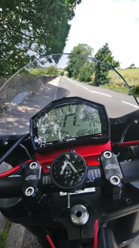

In the images you can see that which appears on the phone. My start point in the east in Heathersage and the end point in the west in Denton Manchester with some northern waypoints I used to false the route. At the start I was on the far side of a car park and the Beeline is guiding 47 metres to the road. In the other shot on route you can see I am 8.9 miles from a roundabout, where I am to take the second exit. The white dot at one o’clock tells me the exit is just to the right of straight on. The faint grid lines tell me I am approximately half way through my total journey. On my motorway the roundabout symbol is replaced by a motorway junction symbol and junction number.

Moderator/Administrator, I could not get this image to display. Feel free to share. If you copy the whole lot in to your browser it will work.
https://scontent-lht6-1.xx.fbcdn.net/v/t1.0-9/126956950_3726475370738176_8378252657882387746_o.jpg?_nc_cat=103&ccb=2&_nc_sid=730e14&_nc_ohc=ff24Pon_uPwAX_tZO_s&_nc_ht=scontent-lht6-1.xx&oh=8942be66edc0d3ec9624b968a147cc63&oe=5FE04DEE
[img]https://i.postimg.cc/Wp0c6hqz/DSC-0438.jpg[/img]

Cheers Docc. I don't know what I'm doing wrong. The img code works fine on two other forums.
You have to use the "Direct" option instead of img.
  • Thanks 1
Regarding the photo.  The big arrow pointing straight ahead means you're going on the route, it would point away in the wrong direction if you weren't.  The small dot on the right means your next turn will be a right turn and 8.9 miles means the right turn is 8.9 miles ahead.  The small scale indicates whether it's a hard right turn or a slighter turn such as a fork in the road or roundabout.  Pretty intuitive.
If you get off course, press the yellow button will recalculate to get you back on route.  Or just continue to ride and follow the arrow until you find your way back to the route.
In compass mode the arrow points in direction of destination.
The small scale at the top is an indication of one's progress through the programmed journey.
