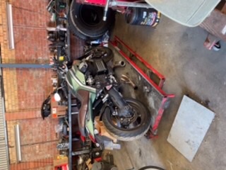

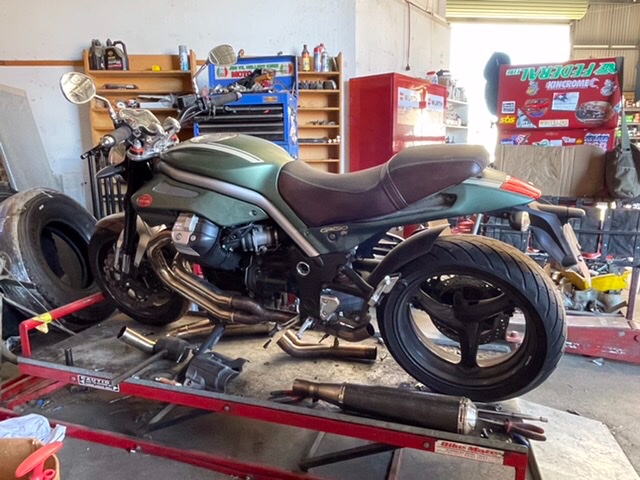

pete roper Posted March 4, 2021 Share Posted March 4, 2021 Whilst of limited interest to most here I thought I'd gauge whether anybody would be interested in a documentary of a single spark 1400 Nuovo Hi-Cam build? I've just acquired a 'Repairable write off' Griso that I'm going to use as a test platform for final development, (I've already built two 1400 single sparkers.). I'm not willing to have my old warhorse off the road while playing silly-buggers with the motor so the idea is I do the build, iron out any problems, then fling the final product in the 'Green Horror'. This will be my swansong. I hope to be retired within a year. 11 Link to comment Share on other sites More sharing options...
