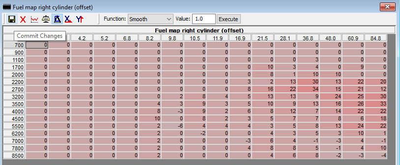

Lucky Phil Posted April 2, 2021 Posted April 2, 2021 2 hours ago, Bob LeClair said: I did replace all the rubber boots but I haven't checked the balance screws yet. Weekend project. Well of course the other suggestions are valid but it depends on when you checked the head temps. The only real way is on the move riding. As soon as you stop other variable come into play. My bike also runs a little different temp one side to another but its also in the nature of the engine architecture. That's why the right cylinder fuel map is different to the left which is the base map and the right has corrections based on the left. The right cylinder's header pipe and intake are different lengths compared to the left due to the cylinder offset due to side by side rods. You can of course adjust the right cylinder offset via Tunerpro. Here's the offset map for a std V11 Sport map MY2000 showing the different injector pulse times compared to the Left cylinder. Left cylinder base map. Ciao 2

Bob LeClair Posted April 2, 2021 Author Posted April 2, 2021 12 hours ago, Lucky Phil said: Well of course the other suggestions are valid but it depends on when you checked the head temps. The only real way is on the move riding. As soon as you stop other variable come into play. My bike also runs a little different temp one side to another but its also in the nature of the engine architecture. That's why the right cylinder fuel map is different to the left which is the base map and the right has corrections based on the left. The right cylinder's header pipe and intake are different lengths compared to the left due to the cylinder offset due to side by side rods. You can of course adjust the right cylinder offset via Tunerpro. Here's the offset map for a std V11 Sport map MY2000 showing the different injector pulse times compared to the Left cylinder. Left cylinder base map. Ciao I wish I understood that better, it's all Greek to me. I'm sure a comprehensive tuning would wake up the beast. 1
