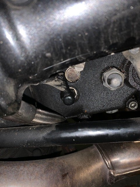

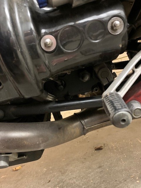

innesa Posted April 20, 2021 Author Posted April 20, 2021 Hi Tinus89 Is this the ground that you were referring to? I'm not very mechanically minded... But this is what I jiggled, & the bike started. Magic!!! Cheers mate. 1
po18guy Posted April 20, 2021 Posted April 20, 2021 While you are poking around, the ground to the trans is on the opposite side - just trace the fat black wire from battery to the transmission casing, pop it off for a bit of a clean, then (if you have some) CAIG DeoxIT will clear out the oxidation and ensure a better connection. 3 1
Chuck Posted April 20, 2021 Posted April 20, 2021 (beating a dead horse) Remember how old these bikes are, and how antique the electrical systems are. Most electrical connections are unsealed, and the above corrosion on the neutral switch is the result. Getcha some Caig DeOxit and completely go through the electricals. All of them. You'll be good for a few years. After all, the most likely failure on any Guzzi is electrical. 6

docc Posted April 21, 2021 Posted April 21, 2021 On 4/20/2021 at 4:29 AM, innesa said: . . . this is what I jiggled, & the bike started. Magic!!! Cheers mate. On 4/20/2021 at 4:36 AM, pete roper said: Neutral light switch. I reckon it's worth knowing what has happened here. A fortunate find from the simple "Wiggle Test" . . . That gearbox Neutral Switch pulls in the middle relay to allow the V11 to start with the sidestand down. If the switch, the connection, or the middle relay fails, the bike thinks it is in gear (with the sidestand down) and won't start (to protect us from ourselves). V11 No-Start Drill: In any No-Start occurrence with the V11, it is worth sitting on the bike, clutch lever in, and toggle the starter with the sidestand >up<. If she fires, the trouble is in this Neutral Switch/connector/ middle relay circuit. Worth noting that when the switch or its connection fails, the Neutral Light won't come on, but if the relay fails the light will still come on. (Perform the Sidestand >up< No-Start Drill) That connector is particularly vulnerable to road skim. Always worth pulling back the boot, tighten the connector, clean the connection, CAIG DeOxit®, and maybe even fill the boot with Vaseline® to ward off the road skim. So: good find @innesa ! But, more important: if that connector failed on your V11, it is fair warning to take care of others. As @Chuck and @pete roper have said, break, clean, and CAIG DeOxit® all your connections. The most important that come to mind: Battery Terminals, Ignition Switch internal contacts, and especially the main ground to the back right of the gearbox under the seat latch. Just visible below the lower/rear seat latch fastener: Rear view with swingarm removed: Neglect this Main Ground connection at your V11's peril. It will find another path to earth the starter . . . 2 4
