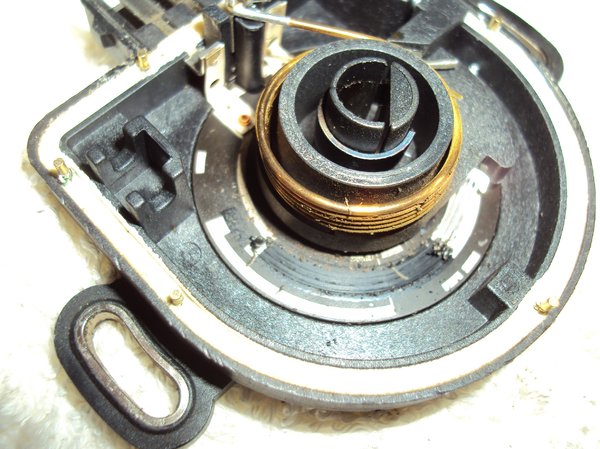

Lucky Phil Posted April 27, 2021 Posted April 27, 2021 On 4/27/2021 at 12:26 AM, docc said: And there is no way to clean or maintain them? Expand The older PF09 on my Daytona yes the later PF03 on the V11's no. My image is of the PF09 Ciao 1
docc Posted April 27, 2021 Posted April 27, 2021 On 4/26/2021 at 1:23 AM, Gerry_L said: Cap in hand and begging for help here. I've been trying to sort my 2002 V11 Sport for way too long and I'm at the end of my tether. I'm desparately looking for suggestions that I haven't thought of. It cuts out suddenlt without warning - complete and instant - but kicks back in immediately I feather the clutch. Sometimes it'll backfire if I stuff up the clutch work but has never stranded me. Some days it will limp home cutting out very few kms, some days it can run perfectly all the way home. (I only take it out when I'm testing a new fix). It can run perfectly for 2-300 kms or it can do it 2 kms from home. Hot weather/cold weather. To date I've tried: - Clutch & sidestand switches - All new 20A Omron relays (and re-tightened the spade connectors in the relay blocks) - New ignition sensor (wiring had gone hard and brittle) - New filter & fuel hoses (with heat insulator over the tank line) - Checked, cleaned and tightened all earths. - Brand new battery (charging at > 13.5V) - Swapped ECUs (it runs a Jefferies myECU unit but I have the same one on my Cali - I can swap them easily then just load the appropriate map. Cliff checked and re-flashed one of them for me when I was fiddling with the relays and caused some mischief). Still to come: - new fuel pump on its' way (not convinced this is the problem but I'm grasping at straws here). - Dismantle main switch and check contactors and soldering. - new fuel tap Please feel free to add to this list - the answer will be there somewhere I'm sure. Thanks in advance Expand On 4/26/2021 at 11:28 PM, Lucky Phil said: Yes docc and here's what the inside of an earlier TPS looks like after a while. Note the crud and debris on the wiper and track. Ciao Expand TPS is conspicuously absent from @Gerry_L's extensive listing . . .
Lucky Phil Posted April 27, 2021 Posted April 27, 2021 On 4/27/2021 at 2:33 AM, docc said: TPS is conspicuously absent from @Gerry_L's extensive listing . . . Expand Just trying to tie the clutch action to the recovery of the running. Can't see the clutch switch having an effect and working the throttle isn't going to recover a cut in ignition or loss of fuel supply. Only thing left is TPS. No guarantee of course. You can buy a new PF3C TPS from CA Cycleworks for $92us Ciao 3

gstallons Posted April 27, 2021 Posted April 27, 2021 On 4/27/2021 at 12:26 AM, docc said: And there is no way to clean or maintain them? Expand With a new one 1 1
