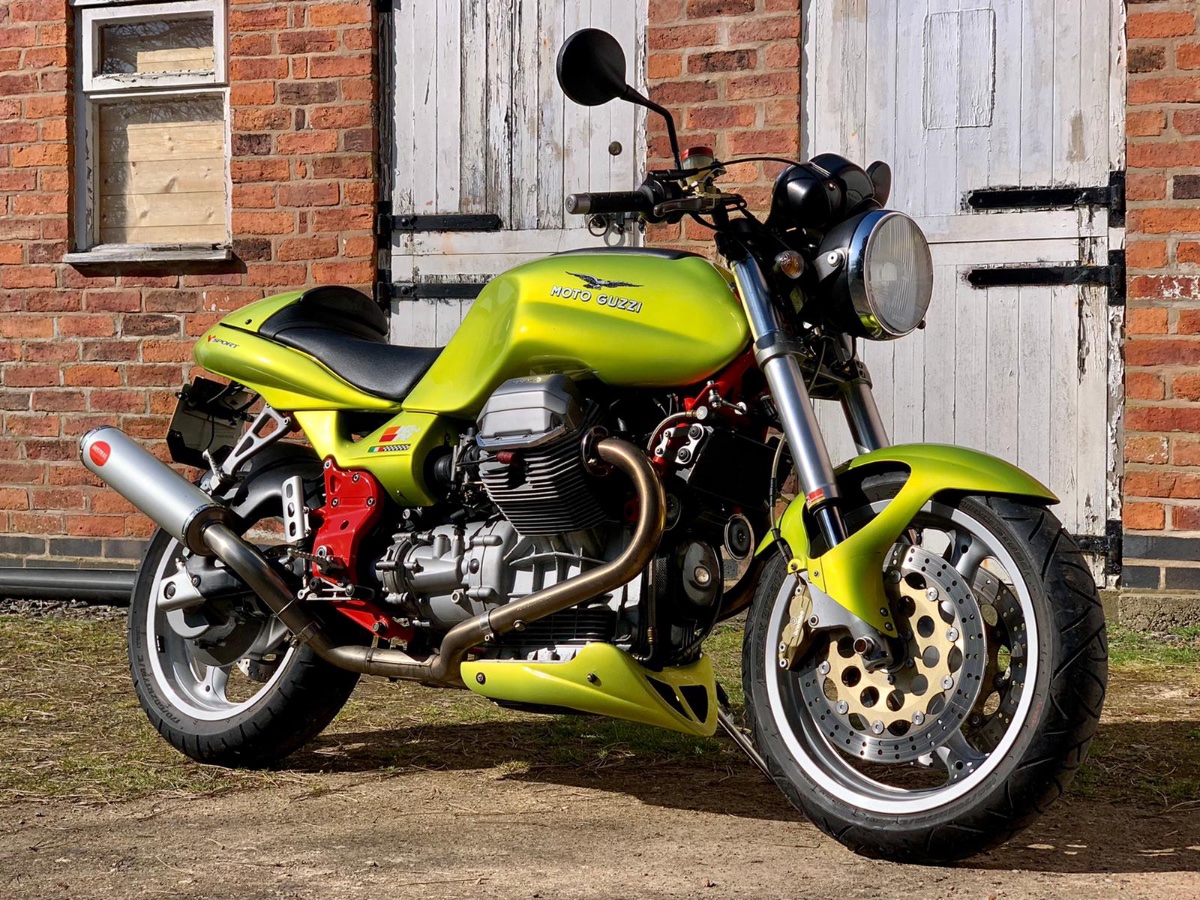

Guzzimax Posted April 28, 2021 Author Posted April 28, 2021 Just bought this rather nice green V11 Sport, to enhance my Guzzi collection. It’s got a Motobatt battery, only 3 years old but now starting to struggle in turning the engine over from cold. My other Guzzi’s all have Odyssey batteries, but I’ve read mixed reports on these and recently had to change a 6 month old one under warranty as it had started to leak. I realise that asking for advice about batteries is like asking for oil brand advice, but I would value anyone’s opinion about which battery to buy as a replacement? 1

Kane Posted April 29, 2021 Posted April 29, 2021 Wow what a great looking Greenie, and what a nice shot! congrats!

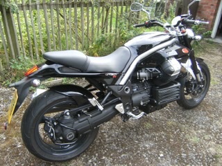

Guzzimax Posted April 29, 2021 Author Posted April 29, 2021 Never owned a Stelvio as I’m not really into dual sport bikes. I prefer road focussed bikes; I’ve got a 8v Griso that I’ve now had for 7 years, and for me the Griso is different enough to a V11 to make me appreciate the qualities of both bikes. I’ve promised myself I will test ride a V85TT this year as my local dealer now has a demonstrator just to see if there’s anything that moves the Guzzi experience on from the CARC bike era, but I’m not too optimistic; for me the various V11’s and Griso are the last of the sporting big block Guzzi’s 5
