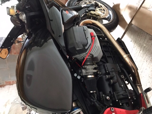

Guzzimax Posted May 5, 2021 Posted May 5, 2021 Been putting my 04 V11 Le Mans back together over the past few days, following getting the tank and seat cowl professionally respirated (they had some deep scratches) So the in tank fuel pump had to come out. I replaced the pumps hoses, fitted a new gasket, took the throttle bodies off, replaced the rubber inlet hoses which were starting to show signs of cracking, cleaned the years of carbon off the inlet manifolds, fitted new HT leads and plugs, front & back wheels off, front powder coated, swinging arm out & powder coated with new bearings. Both exhaust cans resleeved with new covers. Reassembled everything, bike fires up immediately but the revs climb instantly to about 5000 rpm (I then hit the kill switch) it won’t idle. Needless to say everything was fine before this. No doubt it’s got something to do with me removing the throttle bodies. The cable linking the throttle to the throttle bodies is working fine. It’s almost like the throttle control is pinned open, when it isn’t Can anyone offer any advice regarding why it won’t idle, and seems to immediately climb towards the redline?

docc Posted May 5, 2021 Posted May 5, 2021 Well, it's obvious the poor thing will never run right upside-down . . . 3 3
